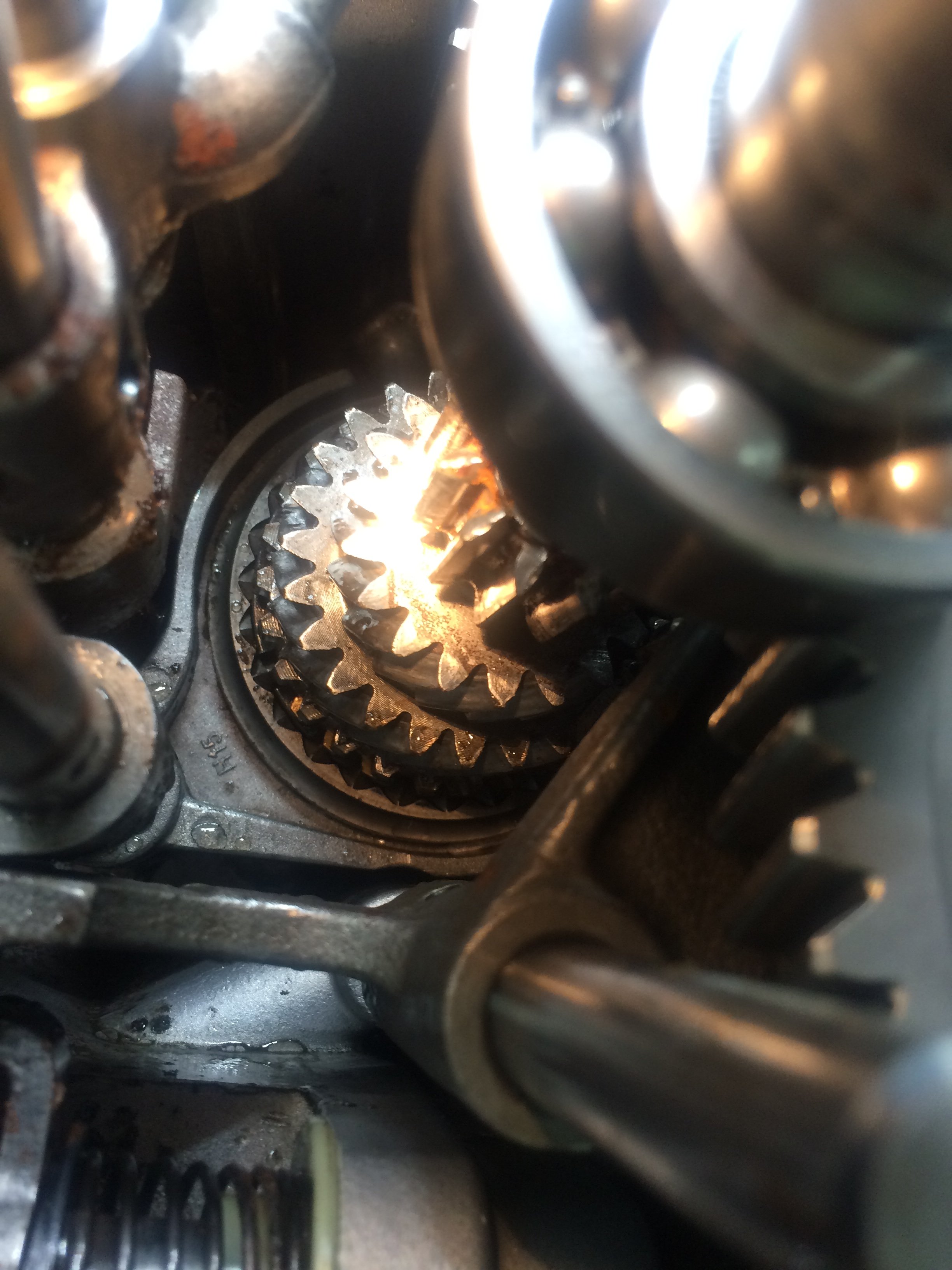

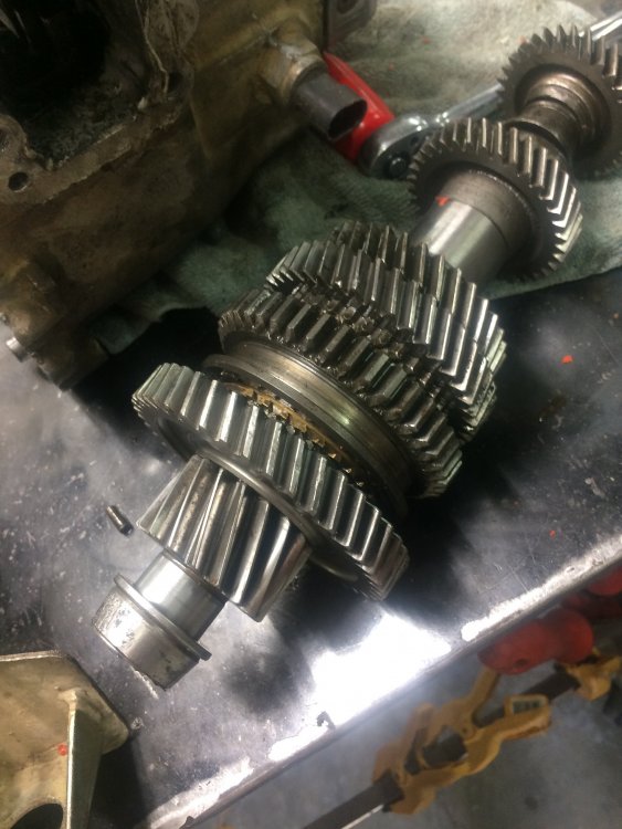

took tranny apart and found my problem was in pic 1218 the bottom gear assembly had bad bearings, the pic 1219 shows where there was a needle bearing that went bad, so I need that one and the one on other side to fit assembly back in tight and in mesh again

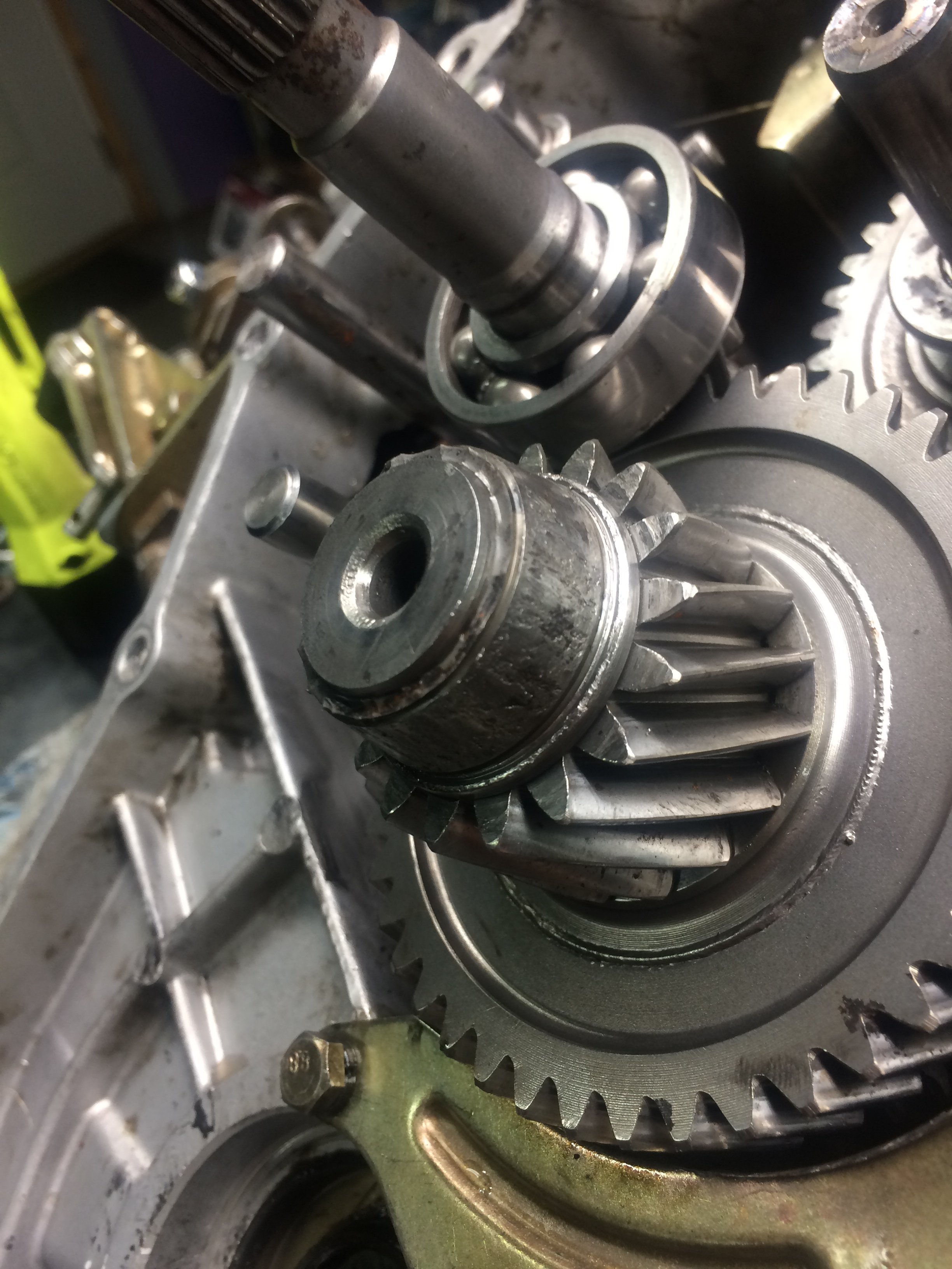

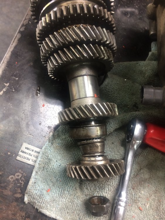

pic 1221 show a set of gears about 5 or so that I have to take out and clean up, they are not ruined but a couple have burrs, that sound feasible to you guys, just can't find anyone to sell me parts yet have email at silverbullet and joyner usa wont know till after noon cause of time difference

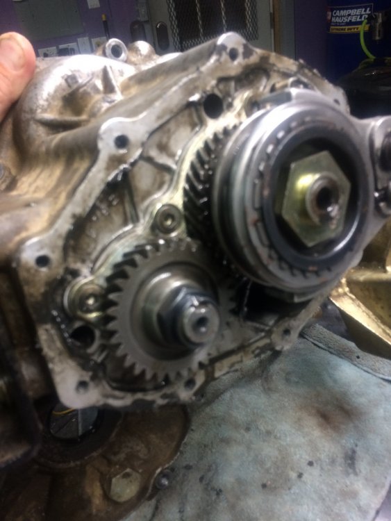

1222 is just pic of unit
what you guys propose, not even sure how that needle bearing removes, but not worrying till I have parts located

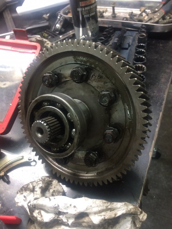

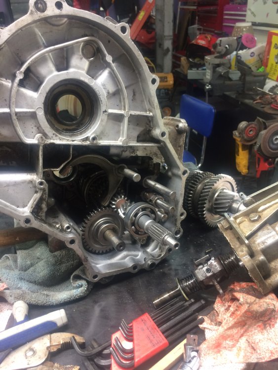

NOT BAD, TWO BEARINGS AND TWO SEALS FOR DIFF
THAT IS FRONT AND REAR BEARING FOR OUTPUT SHAFT, AND ALL ELSE LOOKS OK FOR JUST RATTLING AROUND IN THERE, NOT BAD QUALITY FOR CHINA SOME USA WOULD HAVE DISTRUCTED ITSELF
PROBLEM WAS NO OIL MOSTLY WATER AND SOME OIL MIX

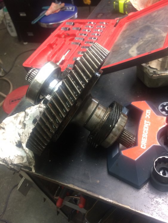

22 IS WHATS LEFT OF BEARING ON OUTPUT SHAFT REAR
23 IS SAME PIC OF OUTPUT SHAFT BUT OUT OF TRANNY

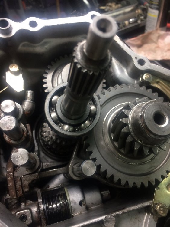

25 IS OTHER END OF OUTPUT SHAFT BEARING FRONT AND REAR BOTH WENT OUT
27 IS WHOLE WHERE i REMOVED OUTPUT SHAFT FROM TRANNY
28 IS OUTPUT DRIVE GEAR, HAD TO TAKE OUT TO REPLACE BUT OIL SEALS
FOR BEING CHINA TRANNY SHIT IN THERE TOOK A REAL BEATING BUT VERY LITTLE DAMAGE AND GET THIS IT STILL DROVE WITH BOTH OUTPUT BEARINGS BEING GONE COMPLETELY...........OTHER GEARS ARE STILL MESHED AND PRETTY SHARP JUST A FEW THAT i HAVE TO DRESS UP TO CUT DOWN ON FURTHER WEAR
ok all rebuilt, two bearings on output shaft and two oil seals did this unit fine..............
