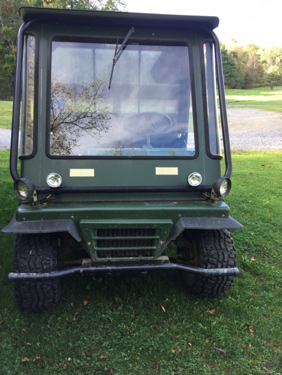

On 9/23/2017 at 1:25 PM, Travis said:
Man, your Stylin'!
Good for $40! How far ahead can you see with them?
Is that a full cab enclosure?
I can see about like a car with these and cab has he solid doors as well.  Even has a heater although it won't get you very hot.
