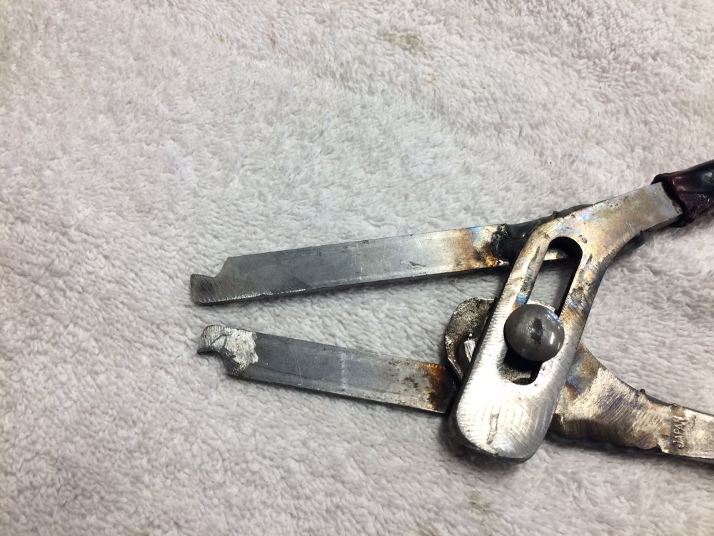

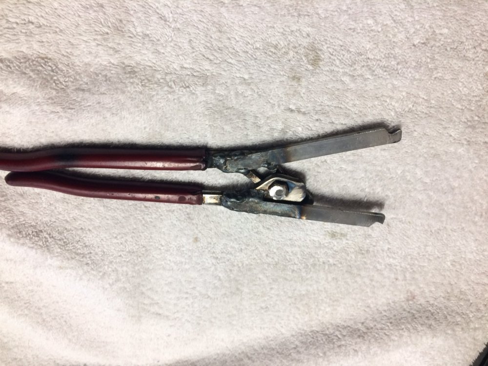

word of caution ....there are four springs holding the exhaust pipe on...be patient taking them off. I made a pair of Springg removers...just to make it easier.
ugly, but they work great...welded two pieces of flat stock ( 3/4 x 1/8") to a pair of  old channeloks
john
I used to work on snowmobiles a lot (before moving south) and their exhaust pipes are held together with the same type of exhaust springs.  I have a couple different "spring removal / installation" tools, but none of them are quite like that.  You might want to patent that bad boy!
