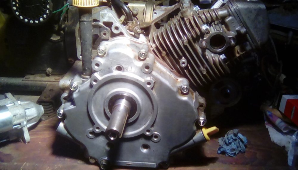

I need your opinion on a few things. Im planning to fire up the engine outside of the mule first, so i dont have to pull it back out in case something goes wrong.
 So, i need to hook up, gas and a way to start it, here are my ideas--- What do you think?
1. I'll hook the fuel pump up and put a line in the gas tank, and run it to the carb.
starting it. 2.,  I think i can mount the starter, and could i take the battery off and use jumper cables directly to the starter to start it??
1 hour ago, kenfain said:
How are you planning on shutting it down in case of a problem ? The jumper cables should work to get it started though.
OOh, didnt think of that. i guess i could pull the spark plug boot off the plug. maybe...
 or if i can figure out a way to ground the magneto, like on a push mower. Fuel shut off valve would take too long......
I'll think on that.....
You know.... i have a spark tester for small engines, i might put the prong that plugs into the boot, and clip the other end to the  spark plug, so that way it won't get so hot... I don't know......
You're wit messed up my plan ;) lol
I just had a VERY RARE occurance. i had a thought.
 I was going to use  a 2 foot wide by 3/4" plywood for the "test stand", BUT, here is my thought, that ply wood will fit on the frame (where the bed sits), and the wiring harness will reach up there, so i can set the engine on the back, and hook up everything it needs to run in a few minutes. and this will eliminate (maybe) any starting problems.
 I got to looking and the starter has 2 prongs with 1 grounding tab, and other things. It would be easier said than done. but this way it'll be much easier. hopefully done than said.
4 minutes ago, kenfain said:
Using the buggy's own wiring sounds like a plan. Let us know how it works.
It'll be a couple of days, just ordered the carb gaskets. That's one thing  i like about Rocky mountain atv, over Babbitt's, you can choose your shipping speed.

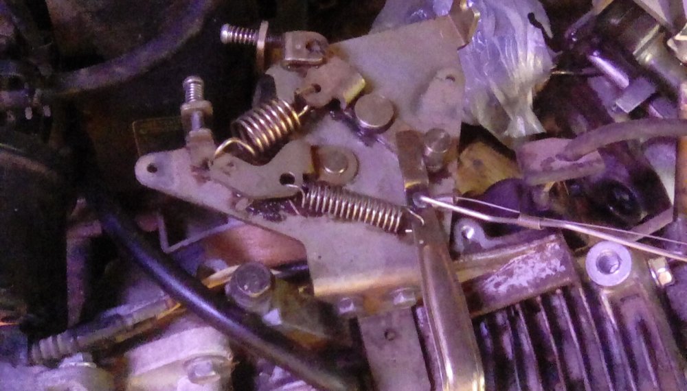

I figured out i had the governor arm in the wrong spot, it's supposed to be on the other side of that stud.
Its aliiiive!!!!!! I mean it runs!!! Fired up first time,  I ran it at varying speeds, and let it idle for a little bit, temperature stayed good on the head , no higher than160 degrees.

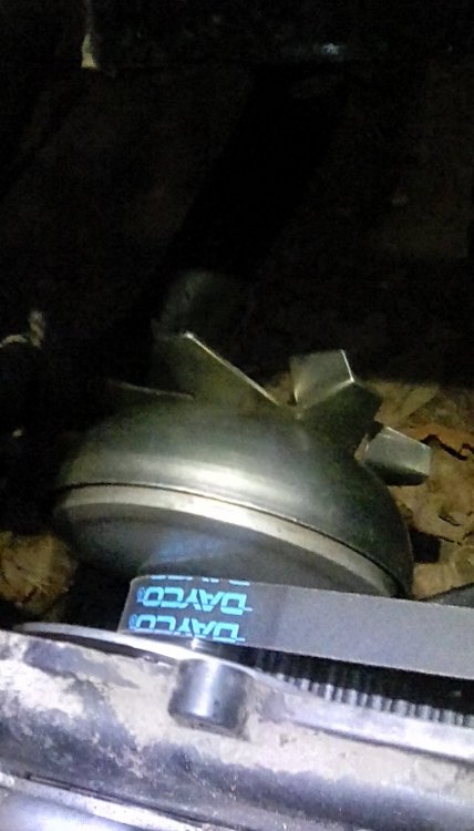

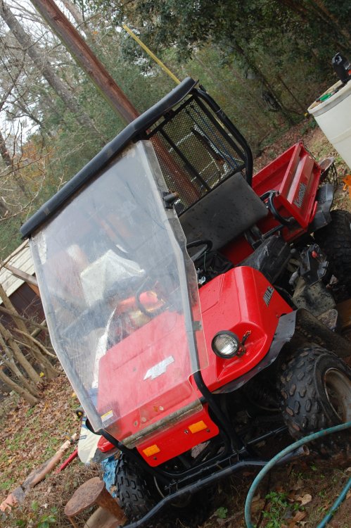

Got it back in the Mule, electric hooked up, stupid cosmetic covers out on, air filter hooked up, just need to put the gas tank in, and put the pulleys on.
I finally called it a day after bending over for the 10 billionth time.
ack!

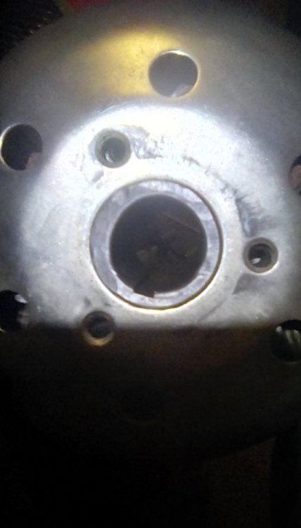

I installed the transmission drive pulley, but i cant find the key for the Crankshaft pulley. I've looked in the bed where i had some parts, nope not there, then i looked in the box and ziploc bags where i put all the bolts and labeled them, not their either! guess ill order a new one,  i installed the fuel tank and pump, i have new fuel line, but it only fits from the pump to the carb,  from the tank to the fuel filter is a different size and local parts store didnt have any the right size. and the old fuel line is dry rotted. and the fuel line i need is about 6:" long and costs 24 bucks.
