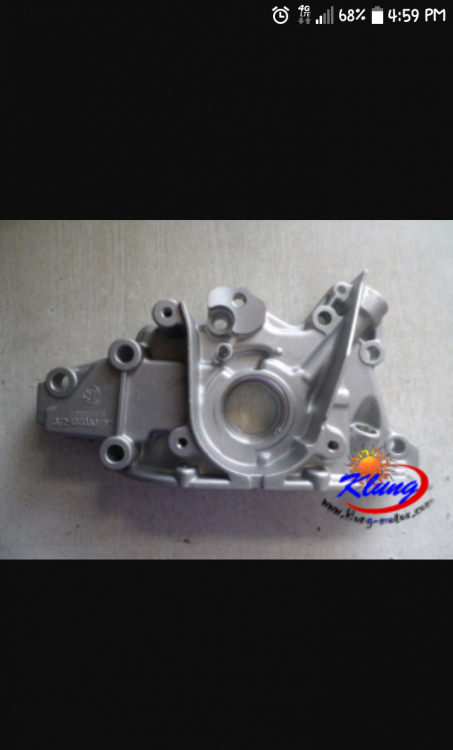

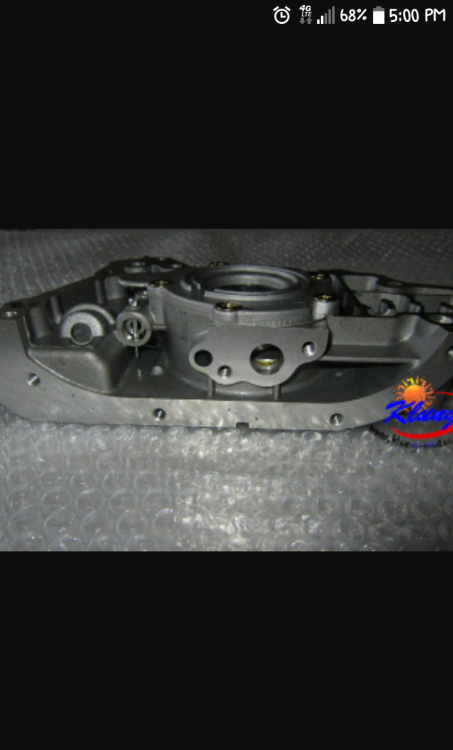

Okay!  Thanks for the info.  I'll look at getting an oil cooler.  There was one time I noticed that my idle pressure was about 10 psi.  Then later during the same ride it was near 20 psi.  I'm wondering if a problem is developing in the oil pressure relief (bypass valve) adjustment; maybe sticking slightly open at times.  I'm not familiar enough with the Chery engines but I do know that regular cars have that adjustment in the oil pump.  Older cars had that adjustment in the engine block near the oil filter.
Mine was similar but, I could attribute the low pressure to oil temperature from the riding I had just been doing (lots of throttle and heavy loads).. I don't have an oil temp gauge but, I just know that the oil was hot LoL!! I'd go with  the cooler and if you got problems still.. I'd say it might be in the oil bypass for you.. If so, it's in the oil pump assembly on a chery engine! But, lets hope not!! LMAO
