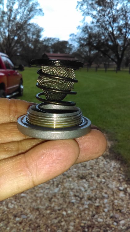

Dropped oil pan bolt to change oil and it to was nasty, let it drain for awhile while I played with grandson. Can back and has some overspill on driveway. Cleaning the belly pan under motor and a spring with small filter from that belly pan from on ground as I was cleaning. I assumed it came from on top of drain plug. Spring fit in plug with a small screen type filter towards pan and I screwed it in, HOPE that is the way it goes. Had to go out of town to work so I stopped there. Headed this week to Tractor Supply for air/oil filters in my work town. I guess I should check gear case oil as I am being surprised on taking someone else's word for maintenance.

This is the spring that I found on the belly pan under motor as I was clean up my oil mess. I am hoping this is correct as I put it back into oil pan???
Anybody know if this is correct before I put oil in it this weekend. Thanks
