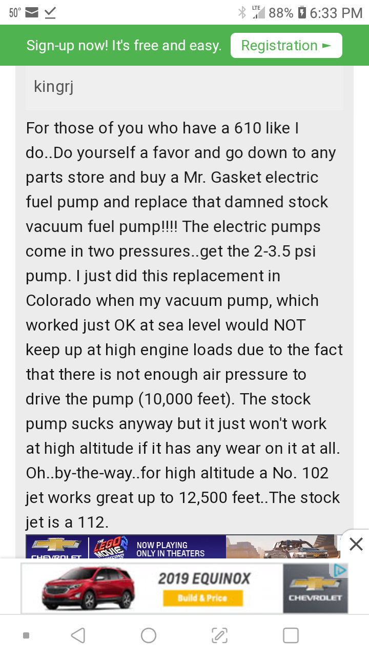

Don't know if this will help, but it looked interesting, and possibly relevant. If you end up finding that the fuel pump is the problem. I'm not sure what obstacle the poster ran into that made him go this way, instead of an actual repair. But sometimes there's little choice. But until we know what the problem is, this is a cheap alternative, and a quick fix. If it's a stuck float, a fuel cut off is always a good idea anyway. And it'll stop that particular issue. Although it won't actually fix the real problem, it'll stop the unwanted gas.

Found this thread reply on another forum, seems to be a common problem with the 610
