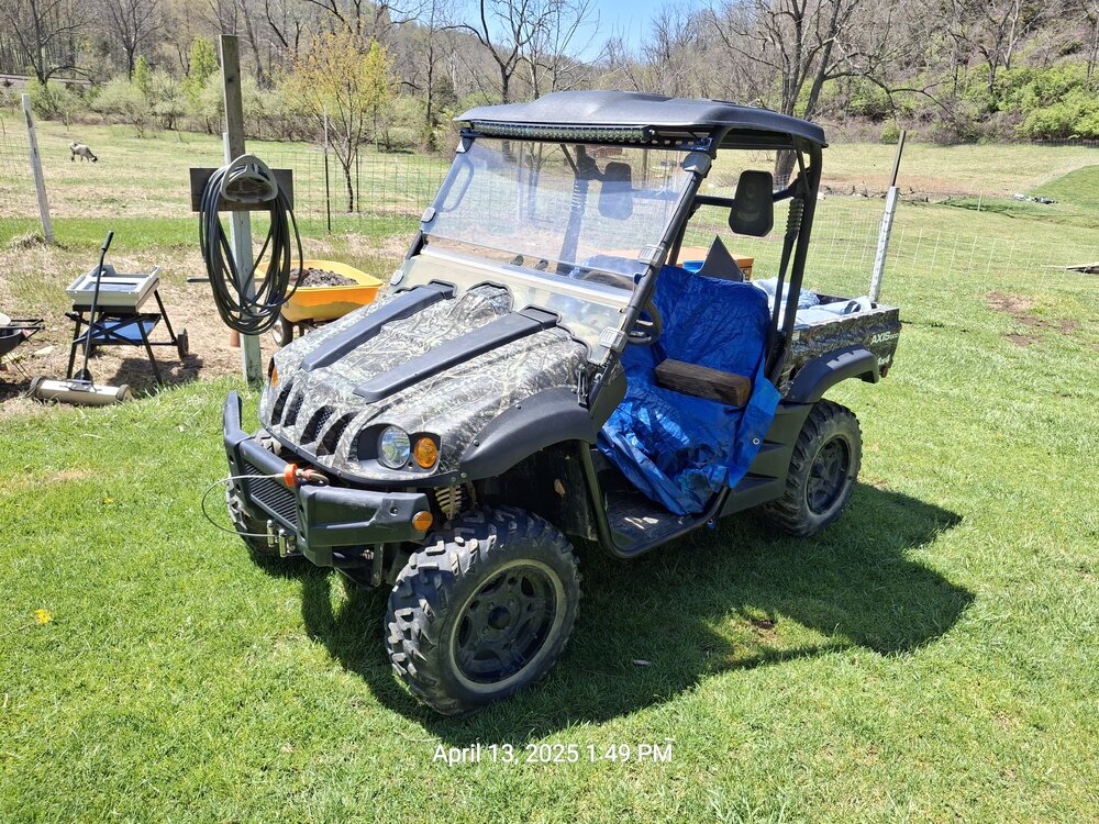

Kinda sounds like some kind of fuel starvation. Possibly clogged lines or fuel pump or maybe the injector. Try disconnecting the fuel line from the injector body and put it in a large container to catch the fuel. Crank it over and see how much fuel your getting. Of course be very careful when doing this and just a few seconds should show you if enough fuel is coming out. If that looks good I'd suspect the injector.
  • Thanks 1
Thank you Steve G. Its 9:20pm wher I live & I'm just now seeing you're reply ,so I definitely try that tomorrow & let you know the results.
  • Alex changed the title to 2021 Hisun Axis 500 No Start - Need Help Please
I'm sorta having the same problem, have a 22 hsun 400, was running and plugged 1 of those small air compressor to air up a tire, about a minute later it just died on me, will turn over but won't crank, only found 1 fuse and it doesn't look blow, so i have no idea what's going on, any help is appreciatede
Could it have jumped valve or ignition timing?  Do a compression test. You said it was spraying fuel. It doesn’t take a lot of fuel to make it idle
