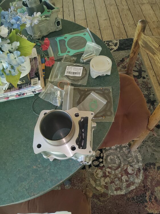

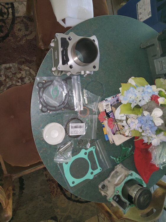

Parts, cylinder, piston, rings, wrist pen, gaskets etc will be about $300-$350 from Amazon or eBay. They have the parts for about $80-$100 for the older engine. But seems those only fit the 2015 and older. Mine is a 2021.
