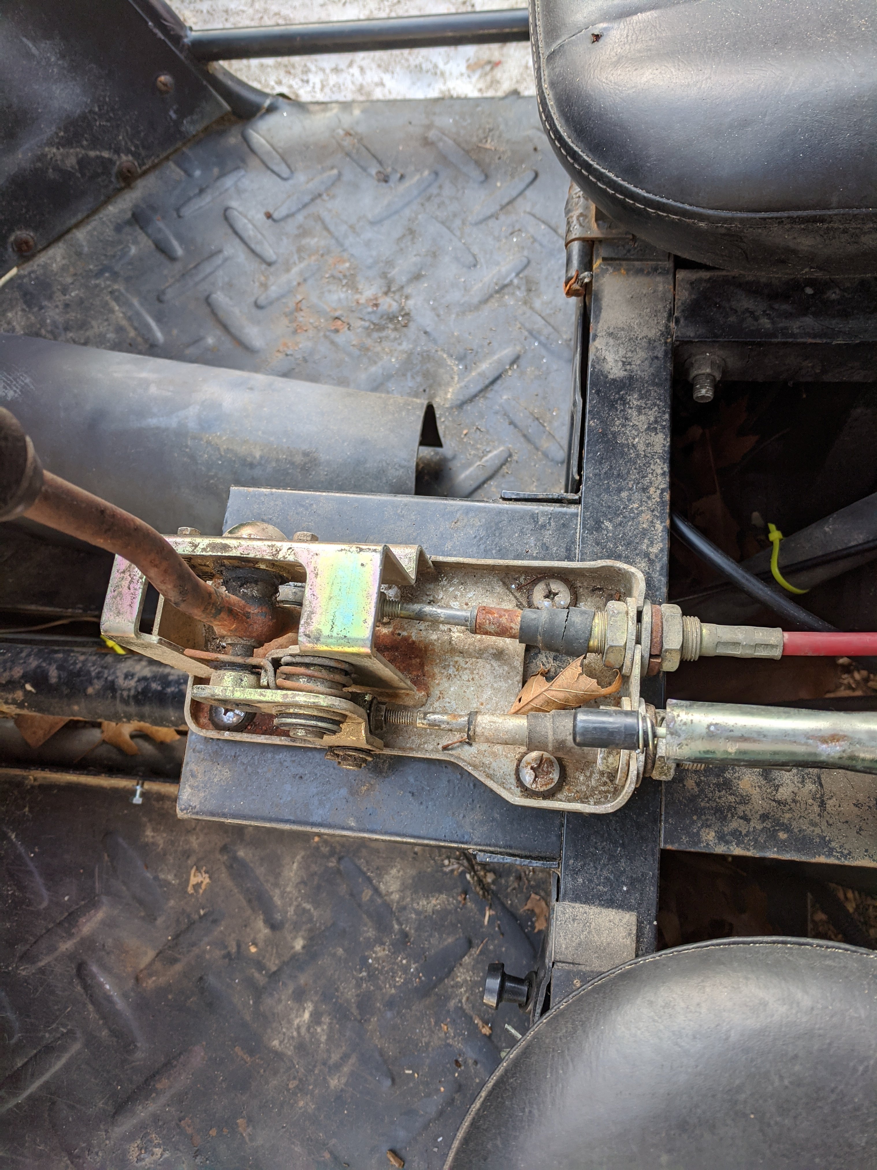

Yes, I got my machine running without a transmission issue, have all gears now.
Gears had been moved manually so I had to figure out how to get them back in sync with the actual shifting lever.
I don't have any pictures of the linkage right now. Maybe this weekend I will have time to take a couple for you.
Bill
Here are some pics of the linkage. Seems like they can only get connected one way.
Sorry for the delay but It was warm out this weekend so I could uncover unit and get a couple of pics for you.
Good luck
