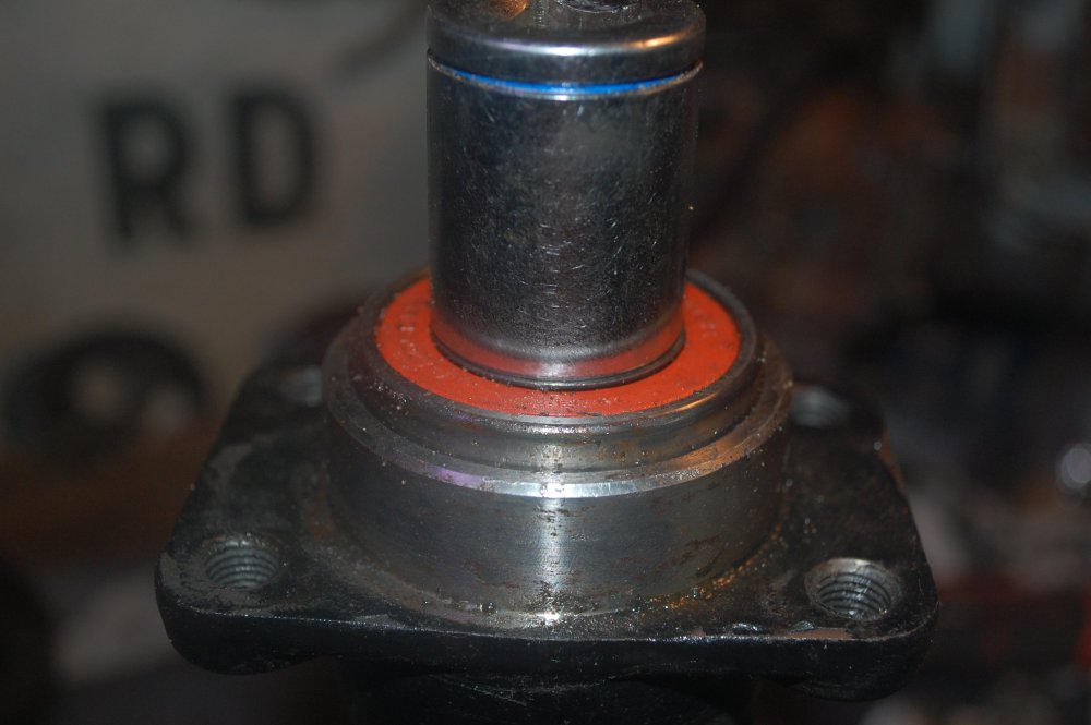

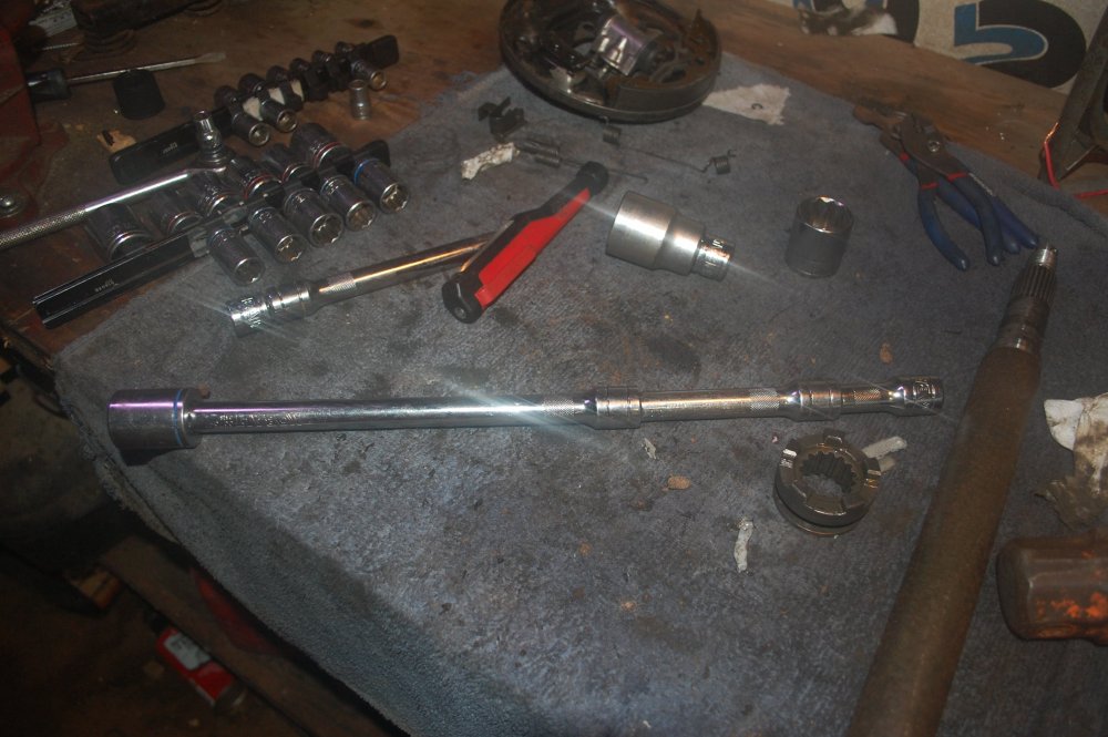

DSC_9068.thumb.JPG.b9d6419f23652ab828fb69a24c9802a1.JPGHere's my home made bearing driver 3 extensions and a 24MM socket to knock the OLD bearing (only) out.DSC_9070.thumb.JPG.540e80410750121c422caedce27d2a83.JPGDSC_9078.thumb.JPG.376649d54b527dc842bd3bad1e95557f.JPG

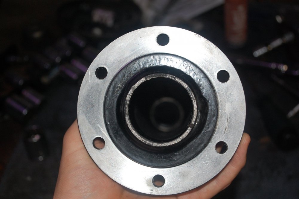

gasket mating surface to the transmission all cleaned up, all theRTV is cleaned off. The manual says to use "Kawasaki Bond silver gasket maker" for $34 a tube hahahahahahaha.
 i have a tube of that Permatex Ultra Black gasket maker, you think that'll work?

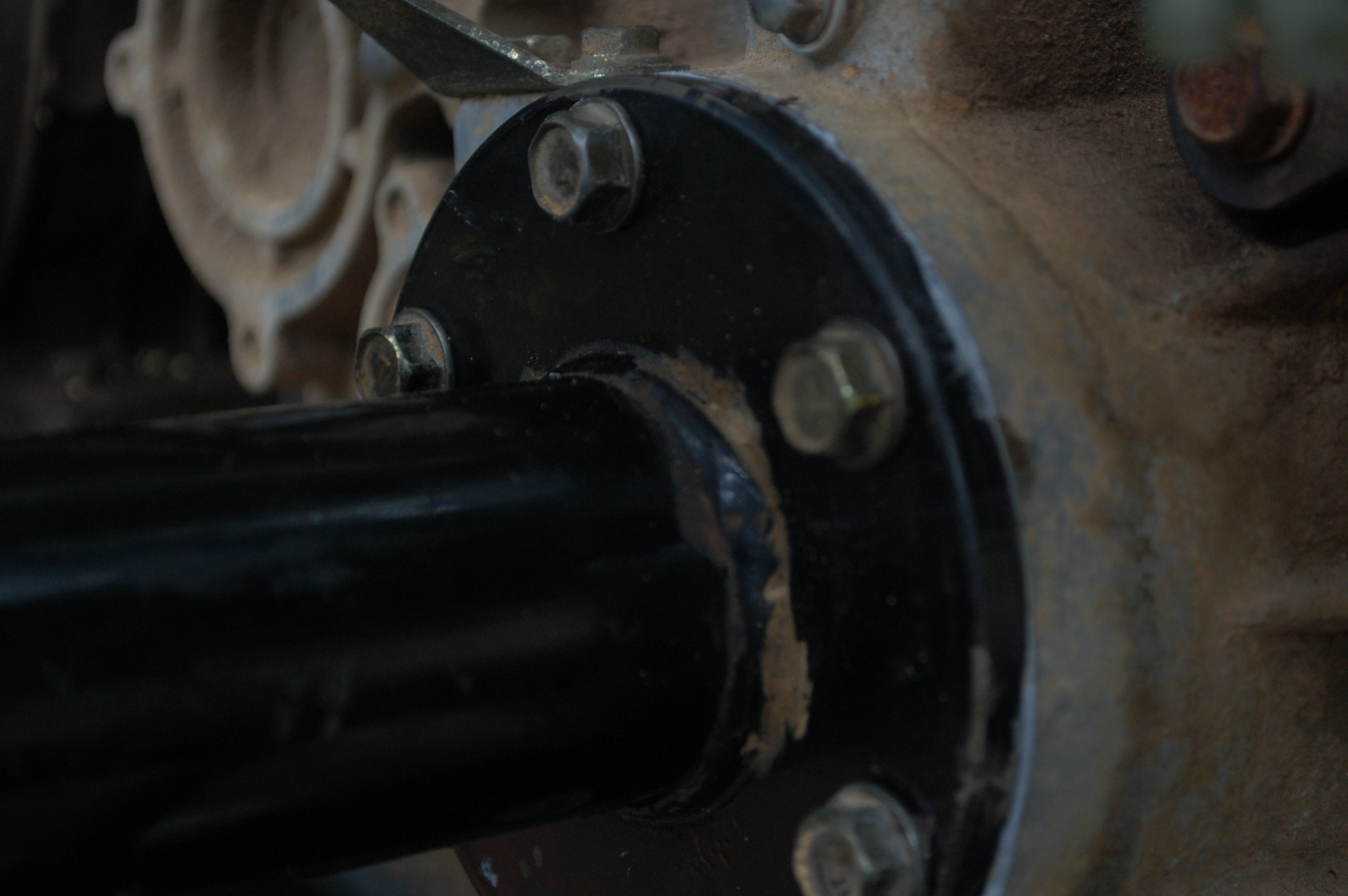

Axle is installed! got the gasket maker squished out a little around the outside edges after snugging the bolts. Got to let it sit for 1 hour then torque to factory Spec.

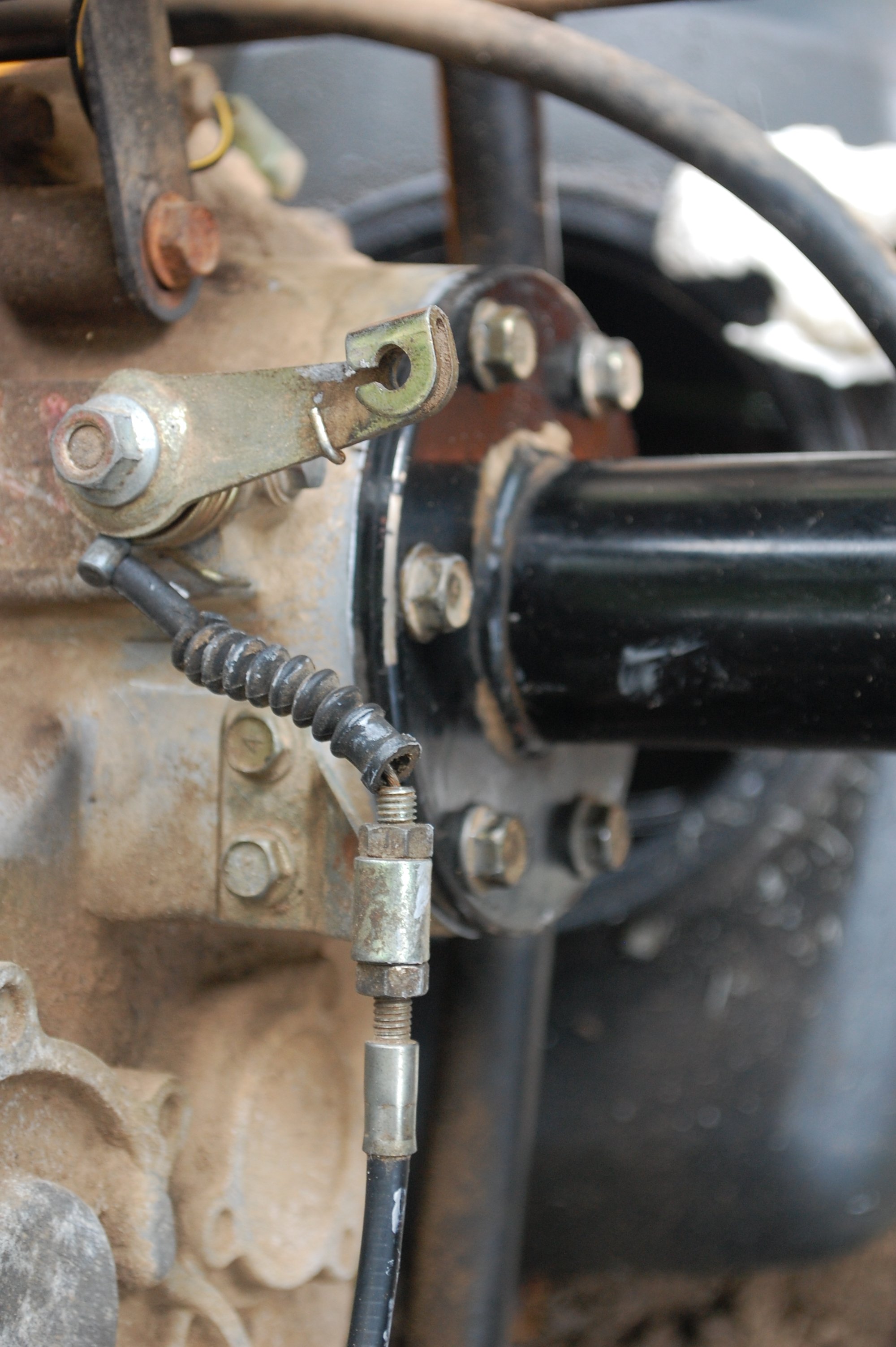

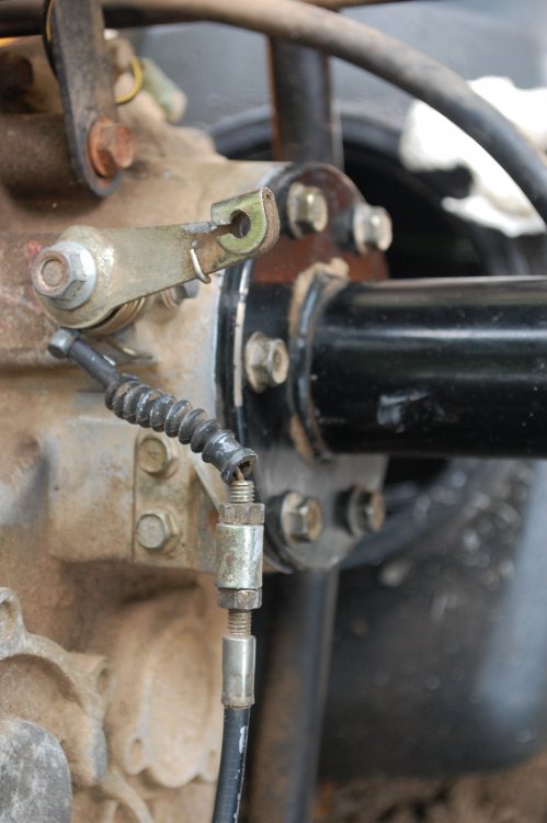

had a little trouble getting it in, since this side has the Diff lock contraption on it.IMG_20190715_155806_hdr.thumb.jpg.41b8cde896fd57265e782ef943306b76.jpgSee the gear on between the axle case and axle? and it has little "castle towers" as i call them on it similar to a Castle Nut, that interlock with the trans gear when diff is engaged, the mechanism has a lever on top of the case attached to a engagement cable, and inside the case is a little dowel pin that sticks down from the lever, (its hard too see but that gear has a machined "groove" in it that that dowel pin rides in) and when the cable is engaged it that dowel pin moves to the right and pushes that gear into something similar to a spider gear for lack of better word, and then rotates both wheels at the same RPM.
amazing what you can learn by tearing into something.

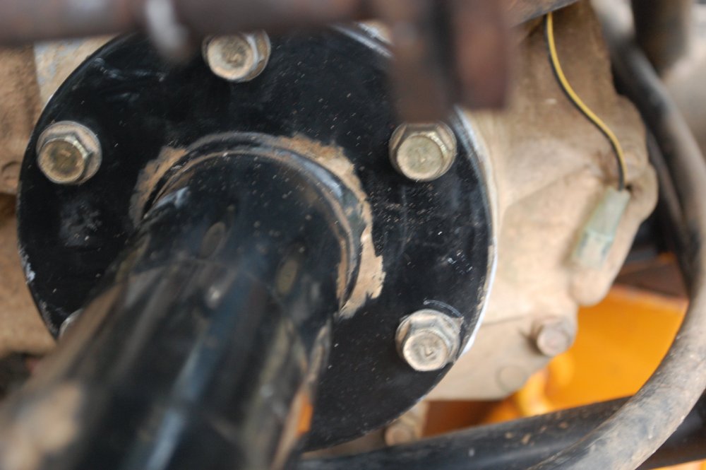

DSC_9079.thumb.JPG.9a99619ceaca25de57e7ff744c81c57a.JPGDSC_9080.thumb.JPG.0d315601f80cf45c3206536665507e01.JPGDSC_9082.thumb.JPG.493268666de1c843e2f2e1f69becc57f.JPGand for anyone else doing this, it makes it ALOT easier if you take the bed off FYI. and these bolts get torqued to18 ft lbs. or 180 in lbs. and the axle mounting bolts to the FRAME right behind the drum get torqued to 25 ft lbs or 300 in lbs.
AND LET THE GASKET MAKER SIT FOR AT LEAST 24 HOURS BEFORE FILLING WITH GEAR OIL
mounting bolts torqued to 18 ft lbs, and i have a nice bead of silicone showing around the outside edge.

Just a thought here, if you use that diff lock. Then you'll want to change that cable soon. If you check that picture you'll see some rust brewing in there. Maybe you could get by with giving it that solvent bath, that you used on the brake cable?

Good eye, i didn't notice it. i  rarely use the diff lock BUT the times i do use is when i really need it.
Oh here's the kicker, you cant just by the cable, you have buy the entire handle or "assembly" $114.00 so it looks like a solvent bath it is, but that's just from online, might call the dealer sometime and see if they can help me find just the cable.
 of course im sure i might could hillbilly-rig a cable with those ends on if does break....
