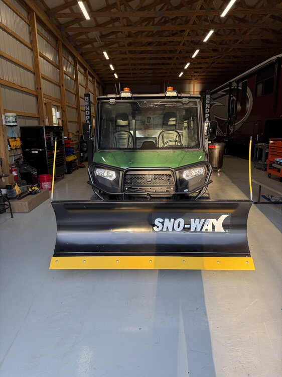

I guess you got a bad build. The only issue I've had is a coolant leak due to a loose hose clamp. No other issues so far. The plow is a sno-way 6' straight blade. Power up/down and side to side. Really nice feature that the sno-way offers that I haven't seen any of the others offer is a power down mode. Most plows are floating or gravity down but this one has a feature that pushes about 300lbs of pressure down to scrape to the asphalt the first pass.

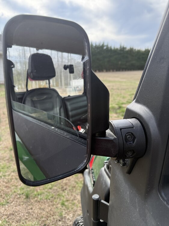

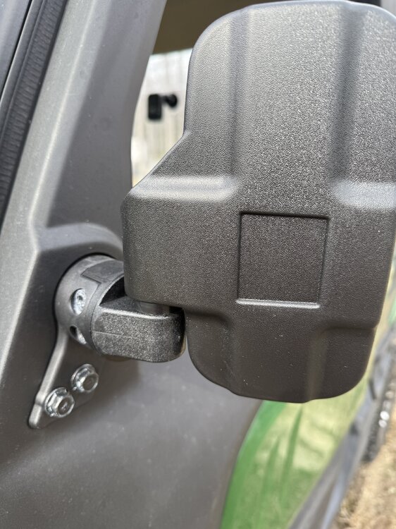

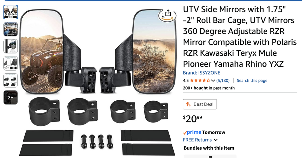

Funny you mention that. I purchased the factory mirrors from Kioti. Well while plowing close to Arborvitaes the passenger mirror broke off. Turns out the only thing holding it on was a bolt just countersunk in the plastic mold. Terrible design! So I replaced the mirror part with Amazon purchased cheap UTV mirrors. They look and work better then the much more expensive factory mirrors. If interested I can upload a pic.
