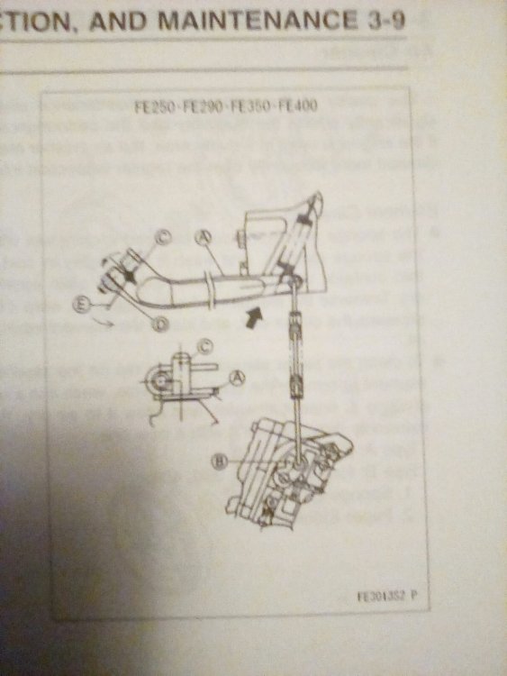

if you want I can upload you some troubleshooting  pages from my shop manual to look at.

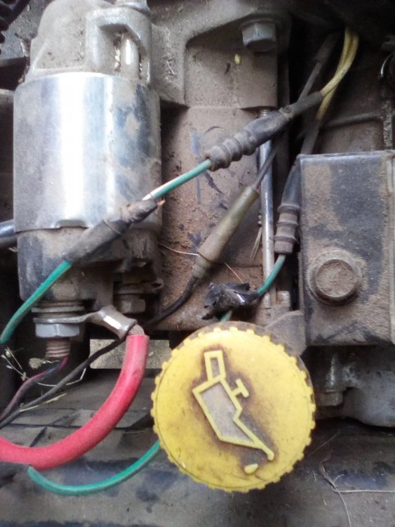

23 minutes ago, Travis said:
Here is the coil ground wire. Unplug it right there. Black wire
It's next to th oil fill cap.

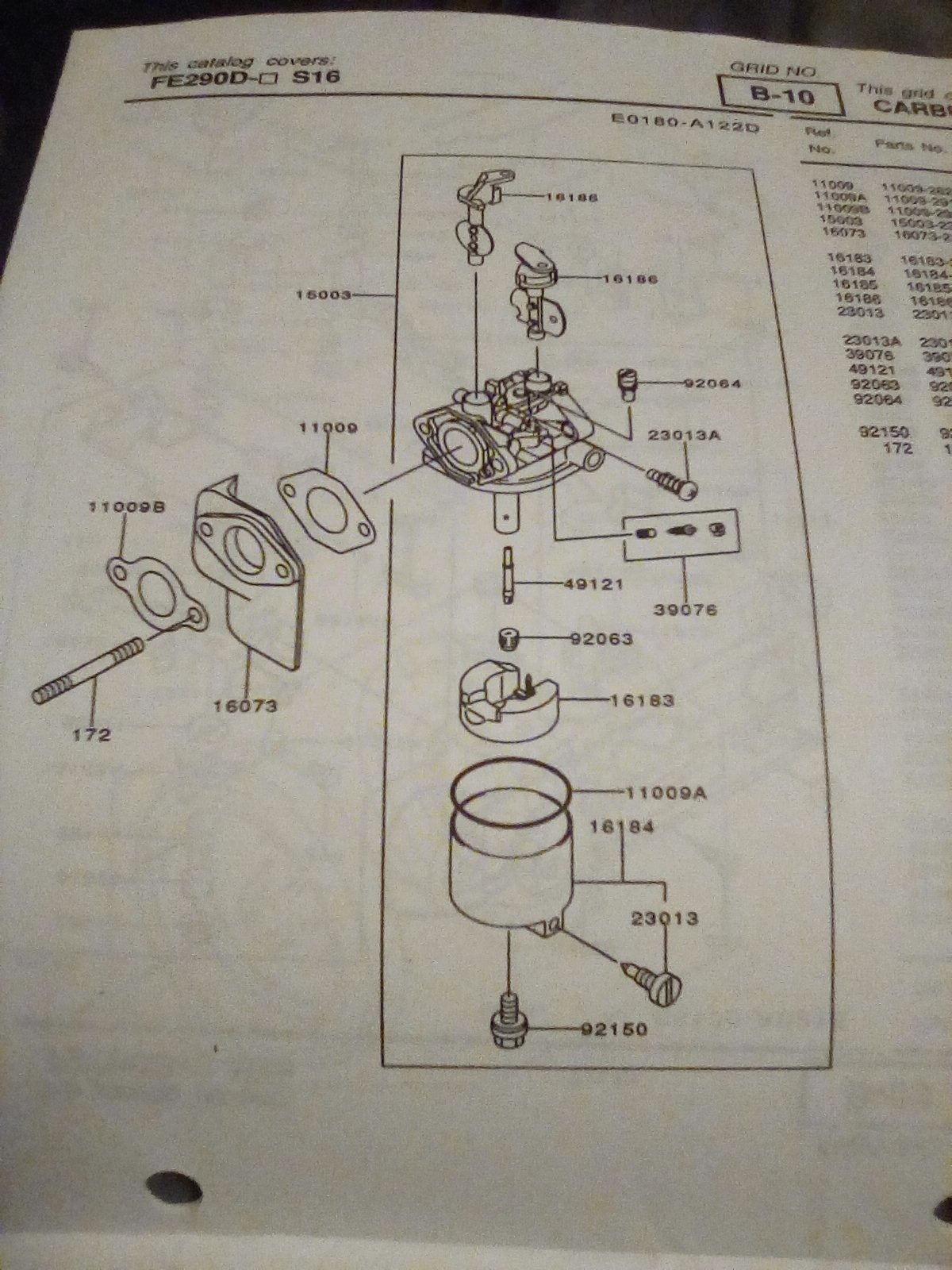

If I am not mistaken there is 1 or 2 gaskets that have a small hole in the corner of them that match up with corresponding holes in the carburetor. But I may be totally wrong it's been almost a year since I put the carb on mine.
Yes there is the small gasket in between the engine and plastic spacer..then the main gasket in between carb and plastic spacer...in question.. That 2nd gasket has indentions..which direction do they face...towards engine or carb...
