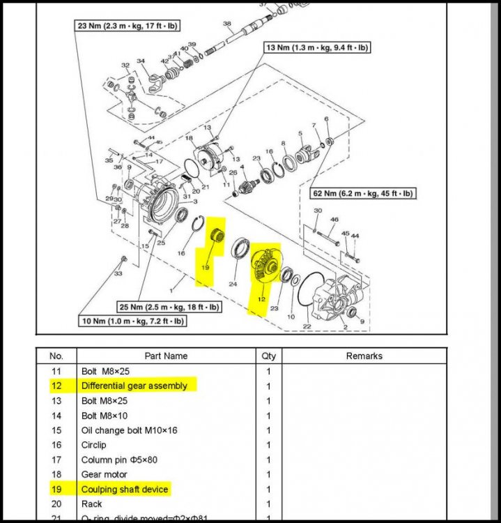

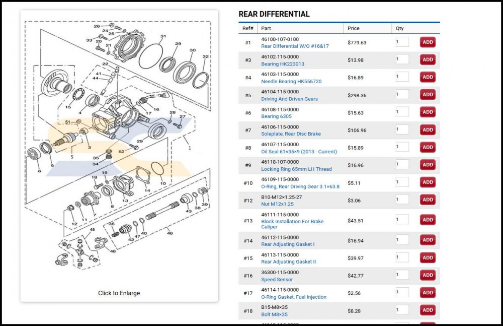

THe Massimo tech was wrong, the vehicle has a final drive gear case, which they incorrectly refer to as the "Rear Differential" in some parts lists I've seen--such as shown below:
However if you study the exploded parts diagram you will see that both axle shafts insert directly into the ring gear hub--there are no side gears, no carrier or spider gears--I.e. no differential. They can call it one but that does no make it one just as calling a cow's tail a leg does not mean a cow has five legs.
My Coleman Outfitter 400 (Hisun HS400) is the same. When I first got it I was surprised by how capable it was in 2WD, then I saw the part disgram and realized it had. in effect,  a full-time "locked" rear end--that explained it...
The front final drive however does have a differential. It is shown in pars lists as an assembly--however it has the distinct shape of an integral ring gear/carrier assembly:
Part #19 above is a sliding splined coupler that in one position locks the differential...
