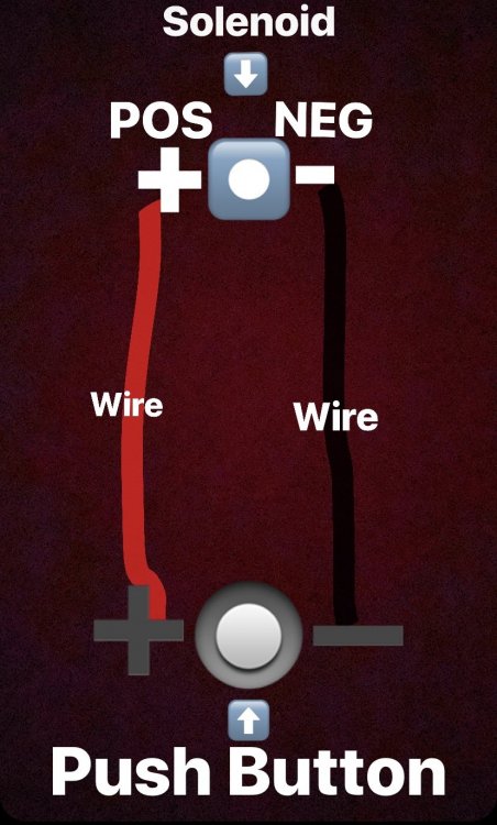

On your solenoid you have a positive and negative run wire from each to a two prong push button once you do that and aslong as you don’t have a bad battery a your solenoid is good it will fire right up I attached a picture of a drawing that explains.
Thanks much! Mine is intermittent, but if I can't track down the issue, I just may install your fix.
