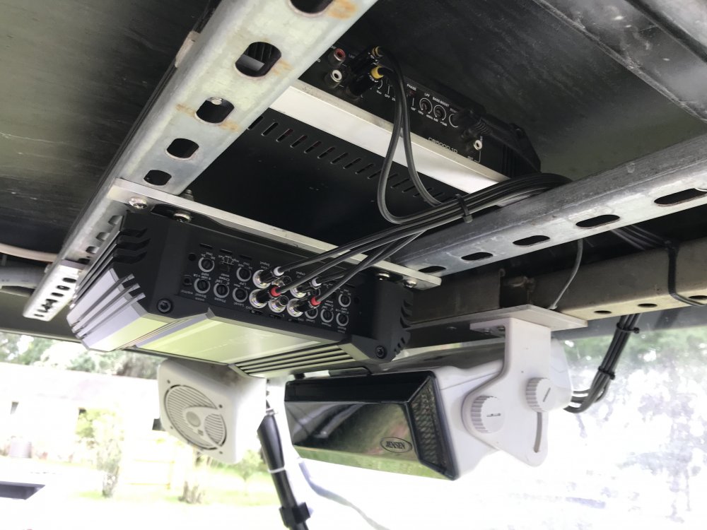

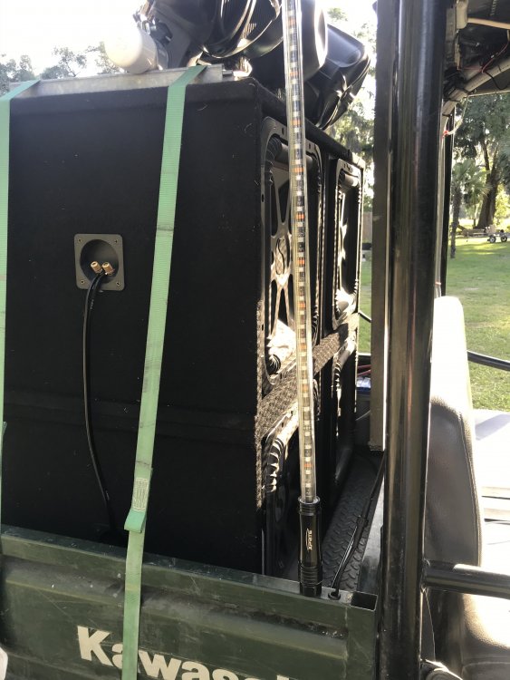

Hello everyone, I have a 2005 3010 Mule and would like to add an alternator, but of course it is no longer available. Will any of the later model 4010 alternators / brackets / belt fit?

The alternator doesn't replace the stator because the stator also provides the timed ignition voltage to the coil, which then fires the spark plugs (it has two sets of windings). The stock stator, according to my information, provides about 15 amps of electrical power for lighting and accessories. The optional alternator can provide up to 50 more amps. Finding the kit is like finding hens teeth though. 🤣
Have you thought about running a small generator instead. Because there's no way that you can pull that many amps without the engine running anyway. So why not a small generator? They're fairly quiet, and would be multi purpose too. Similar price, easier installation.
Get yourself a 2000 watt inverter generaor (for quietest operation) and 100+ amp 12vdc power supply.  Bolt the generator to the back.  Then go for a ride.  Alternators for UTVs and ATVs are barely large enough to run the lights, computer, fuel pump and ignition system (about 400 watts).
