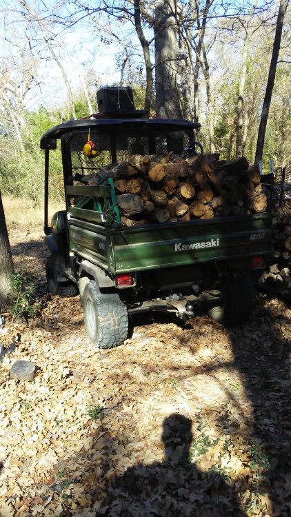

So be honest with yourself, and know what the realistic end use will be. And buy the best you can afford. Buy once, cry once. I would've preferred the kubota.  But the aftermarket for the mule was much better. 20171210_125337.thumb.jpg.8b54f855d6c2c46be71c33da8d6d09ee.jpg
Here's mine.
