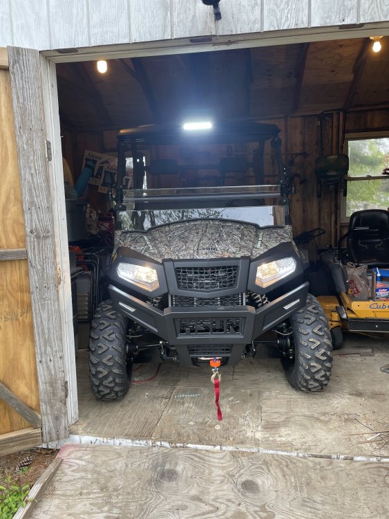

I added a 1,000 lumin light bar to my Hisun 550 sector. I drilled holes in the roll cage and used a wire snake to run the wires through and I ran a switch off the blank in the control panel, I tapped into the 12 V cigarette lighter wiring for my power.
