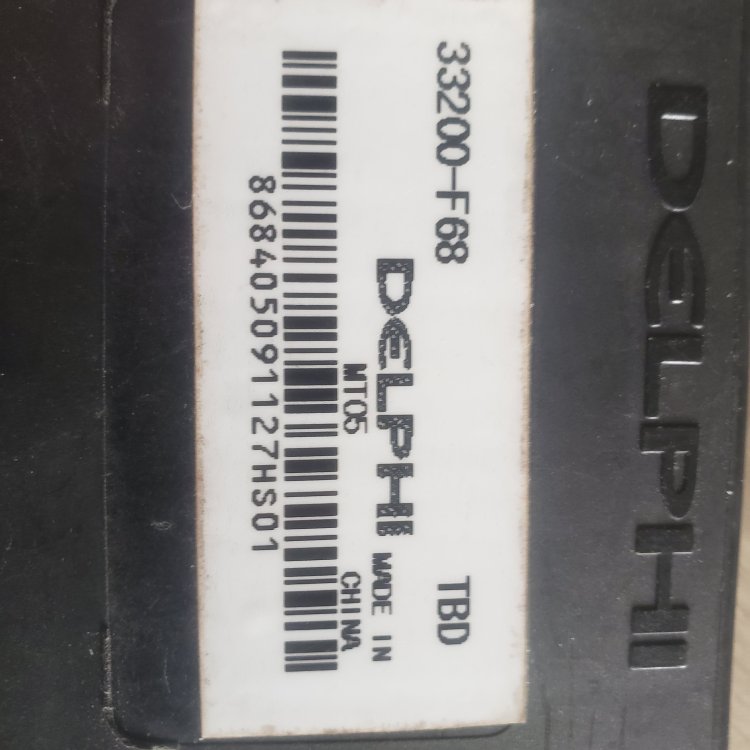

It does, I switched them around but didn't make a difference.  I'm looking at new ecm fron $80 - $150.  Alot of them say for hisun 800 but have different numbers.
Just wanted to give update . It was the ecm. Put new one on and got spark immediately to front cylinder.  Ran but smoking and no power. I checked back cylinder and no fire. Pulled coil to check with meter and found wire was not getting good connection where it plugs into coil. All good now . She will scream !!!. Next is to figure out why 4x4 switch wont turn.  Thanks for all the imput....
