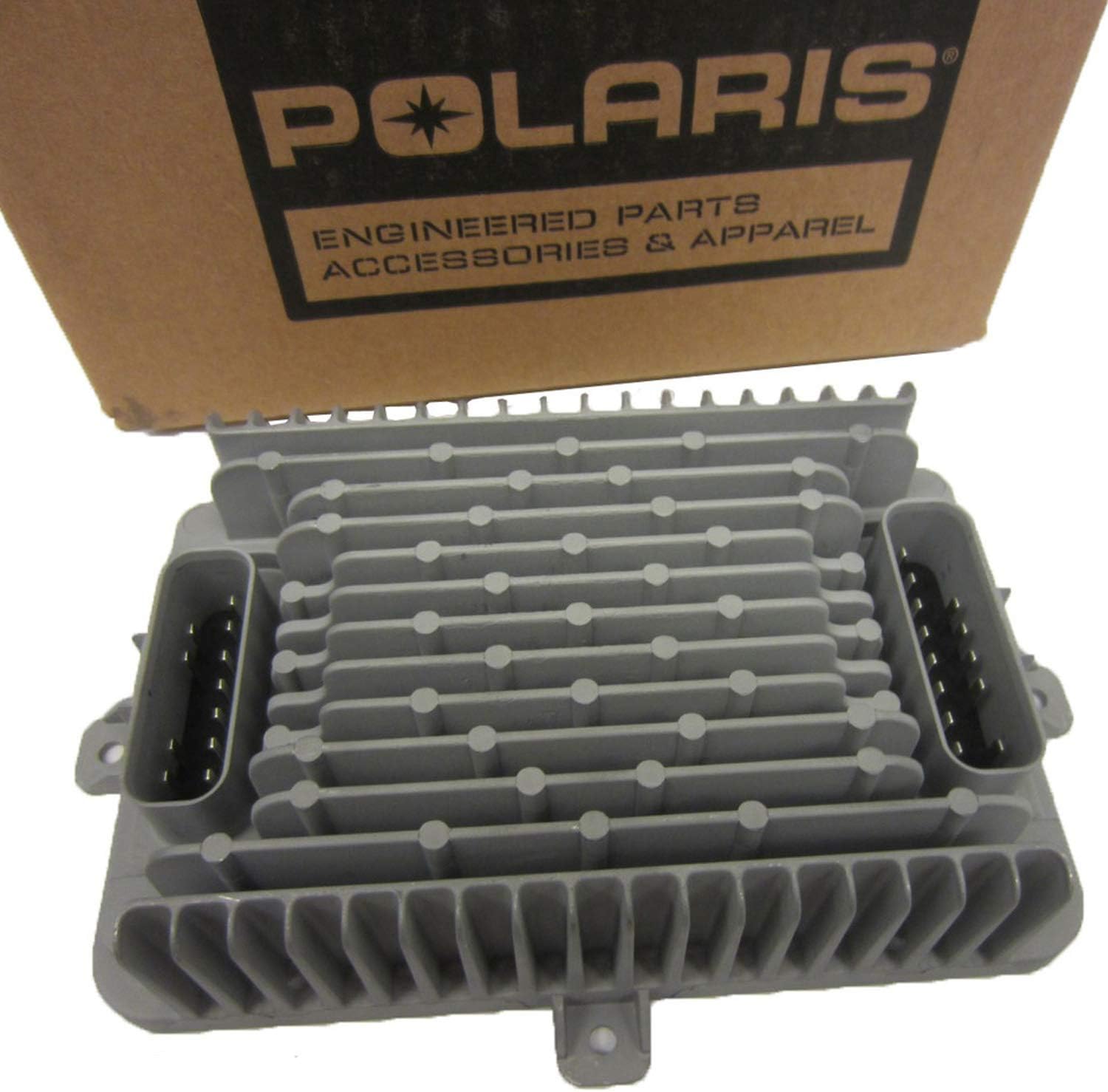

HI new to the forum so this is my first post and problem. So I have a 2005 Ranger 500 6x6 with a carb and do not have any power to the fuel pump. Research has suggested that it could be the pdm but after looking extensively through my machine I cannot find a pdm. I can only find 3 flat black thin boxes under the hood on the passenger side. Are there some ranger 500's without pdm's? I bought this machine new and it has never been messed with. This machine has been in storage for several years and has only 12 hours on it.
Thanks, Jeff
My Bad just looked at my title and its a 2004 not a 2005 so no PDM or ECM. Wiring is quite different so I need to take another look.
This is what a PDM looks like and according to Polaris your specific model has one : spacer.png
 And it does appear to be mounted under the dash according  to parts diagrams... but it looks like on the driver side?
