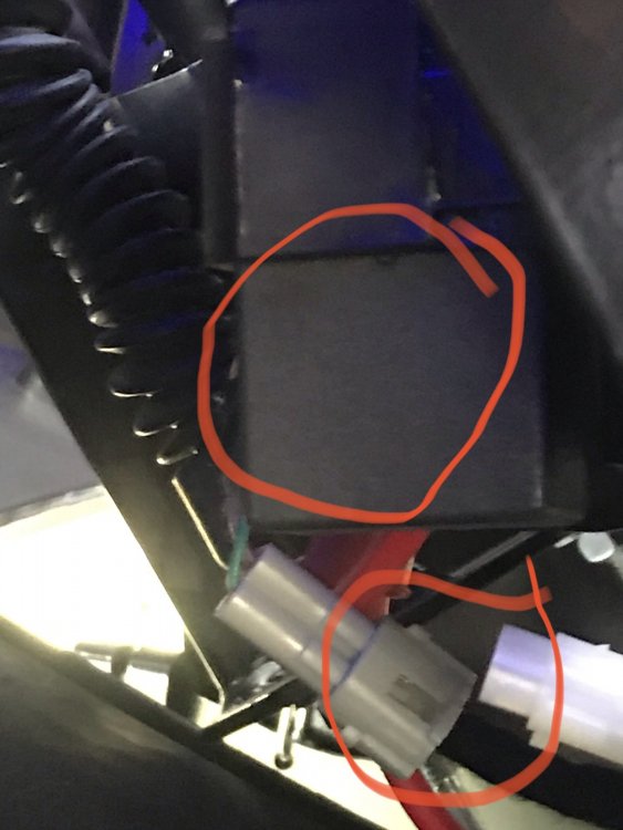

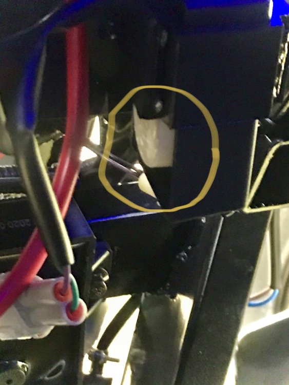

Ok right after I posted the question I found it!! In the first picture it was taken looking through where the gear shift is and the second is the back side of taken from the front right wheel well!   Hope this helps anyone in the future!
T-Boss 410 side by side supper loud backup beeper alarm is located on the passenger side behind the battery. Just unplug it and maybe use that circuit for back up lights. Best access in through the shifter panel on the dash. Remove the shift knob and the three screws on the panel.  Reach in there and unplug the beeper.
