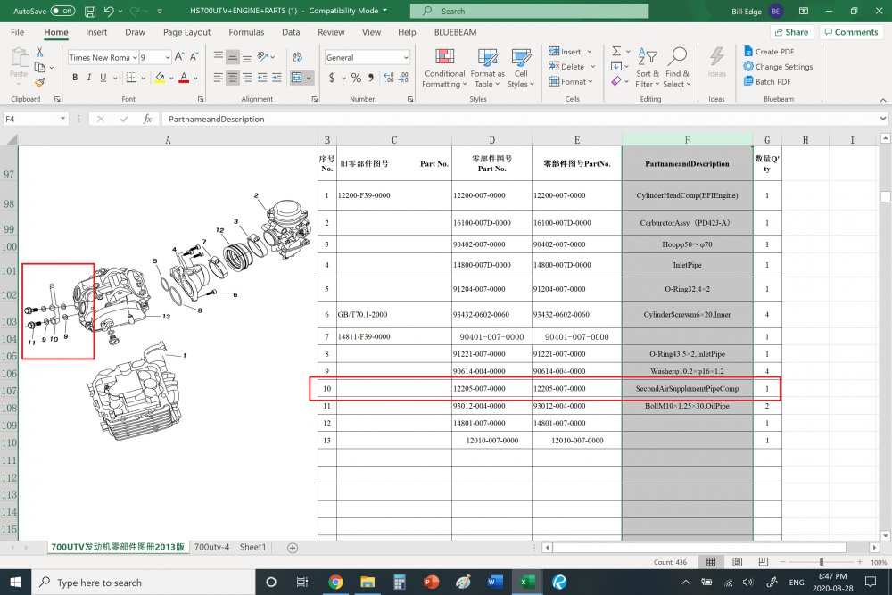

If you lift the back, look at the exhaust and just above it is the port here is the parts breakdown - the guy told me to remove it, seal it with smaller length screws and plug the hose or
remove it completely - my guess is that i just take out the 3 way connector, connect it directly to the fuel pump and see what that does.
