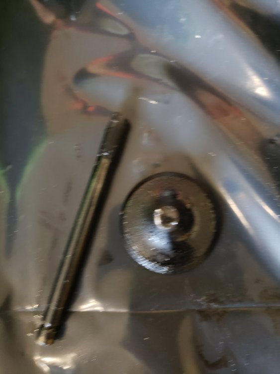

Update......looks like I busted something.....20200725_133938.thumb.jpg.31fd03b20b63d6cb59fe8ba49e41f4f4.jpg
What could have caused this....

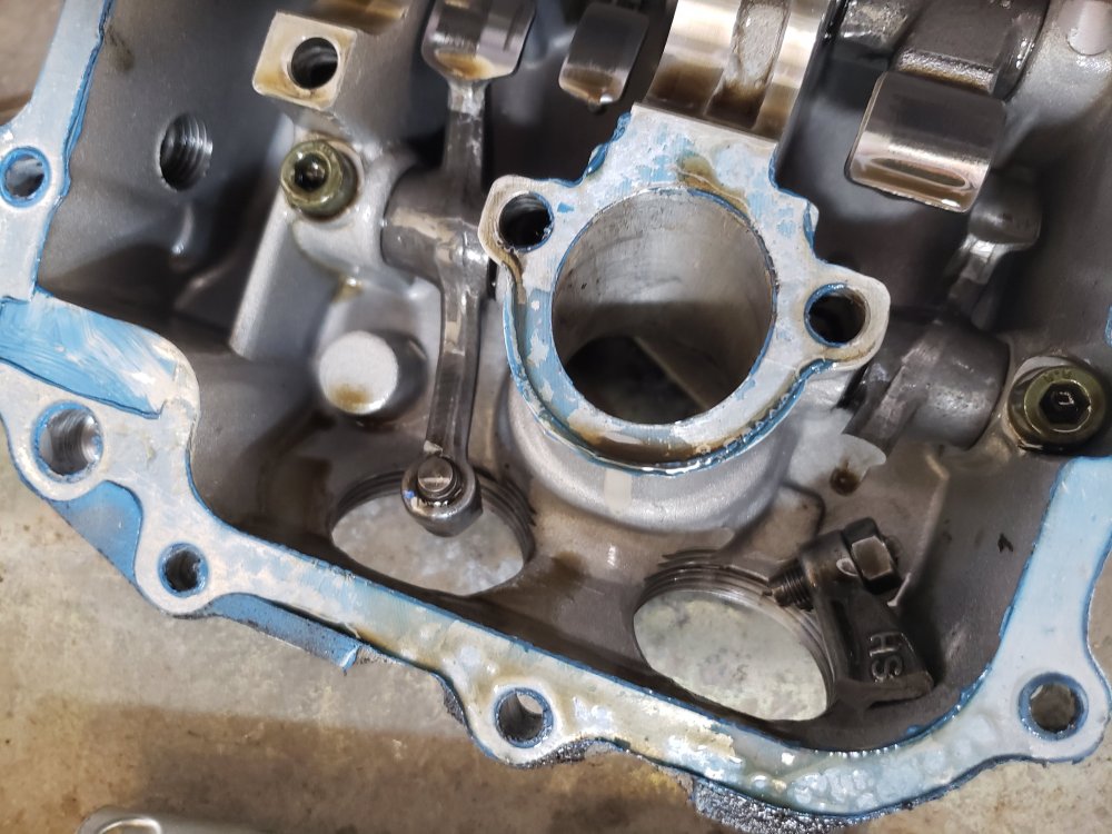

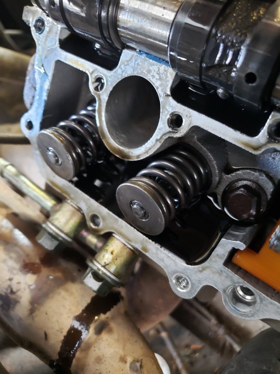

Also 20200725_134040.thumb.jpg.b53a1ae5d3e911b1a4b54b66c3ac769e.jpg20200725_133934.thumb.jpg.f0e58d926340b8e937ff625654f66722.jpg
Engine still can't crank over by hand.....It comes to a hard stop.....moves  aprox 180 deg the hits a hard something....broken valve?
well, you'll  definitley need a new rocker arm on that right side..
Is the spark plug out when you're turning it by hand and it stops? If not, take it out and spin it by hand, if it's easier, then it could be a problem with that valve not opening causing excess compression....
if the spark plug is out, and it's still hitting... I would look for a brok valve, or valve seat popped out holding the valve down into the cylinder...
May be easier if you remove the head and inspect and look at everything.
Well I found the culprit....broken exhaust valve.
piston looks ok....appears not to have done any damage, probably because I was just cranking and not running.
Lucky for me the previous owner had a number of spare parts and gave me the old head....going to rob the rocker arm from that.
Going to rob a valve as well....looks like it's in good condition....no putting on the seat. Going to get some lapping compound and see how it goes.
I know you will, but i can't stand not to stress it.. clean that head as though your life depended on it after lapping... That liquid sandpaper won't be good for it at 3,000 RPM...
