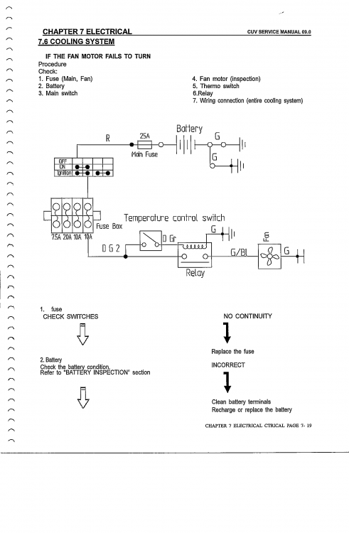

My Question, exactlely where is the thermoswitch located? and would you please post a picture of this Thermoswitch which appears to be a relay triggered by a heat coil. Is that correct?
on mine, the switch which turns the fan on and off  at preset temps is located on passenger side of radiator . Fan is NOT controlled by ECU. .it has a 2 wire plug-in.. simply unplug and jump the 2 wires .. Fan will then run when key is turned on.. mine was running 230-240 degress causing masive overheating and parts failure.. it now stays 170-180 degress on 100 degree days .. that switch was factory set way too high ..we used a infrared thermometer, the switch would not turn on til 220 degees and turned off at 190 .. but its on the return side .. thats how hot the water was going TO the engine.. poor design ...I tried to find a switch with low set temps or adjustable temps but could not .... Anyway, waterflow is adequate, it just needs far more cooling of the water BEFORE it returns to engine..  Thats my opinion at least. My mechanic agrees .. AND ITS WORKING.. I can run it hard all day... never runs hot now
Thanks Joe, I will have to see if I can even get to the radiator. This thing is almost all enclosed in plastic! The service manual has a lot of information, but is sadly missing any "how to get to" pictures and information.  If I figure it out I will try to keep good notes to be posted here.
So as I understand it, To make the fan run 100% of when the switch is on is to find the Thermoswitch that screws into the bottom of the radiator on the passenger side of the radiator and jumper the two wires and just leave the thermoswitch without any wires? is that correct?
