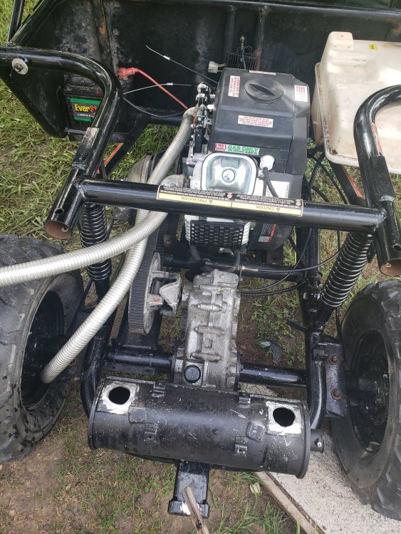

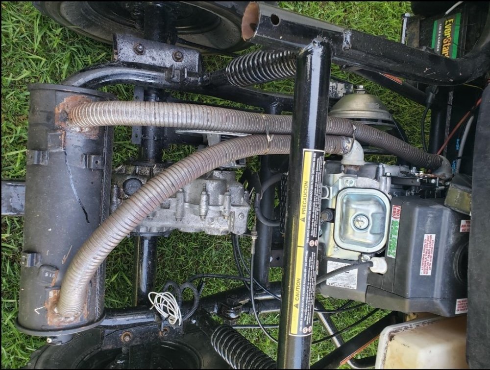

American Sportworks UTV, I swapped in a Predator 670 engine. I relocated the exhaust which was originally bolted to the side of the engine, to the rear of the buggy, via some flexible exhaust pipe. It runs like crap and I think maybe the reason is my exhaust is adding restriction. So I would need to put in smaller jets, right?
Also, the jets installed at the factory are two different sizes. The reason for that as I read somewhere, is that (with the muffler in the factory position) the exhaust gas path through the muffler is longer for one of the cylinders than for the other. I think my added section of pipe might negate that difference. So should both sides be jetted the same now?
Does anybody know where to get jets for this?
