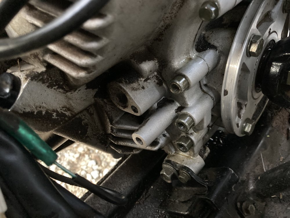

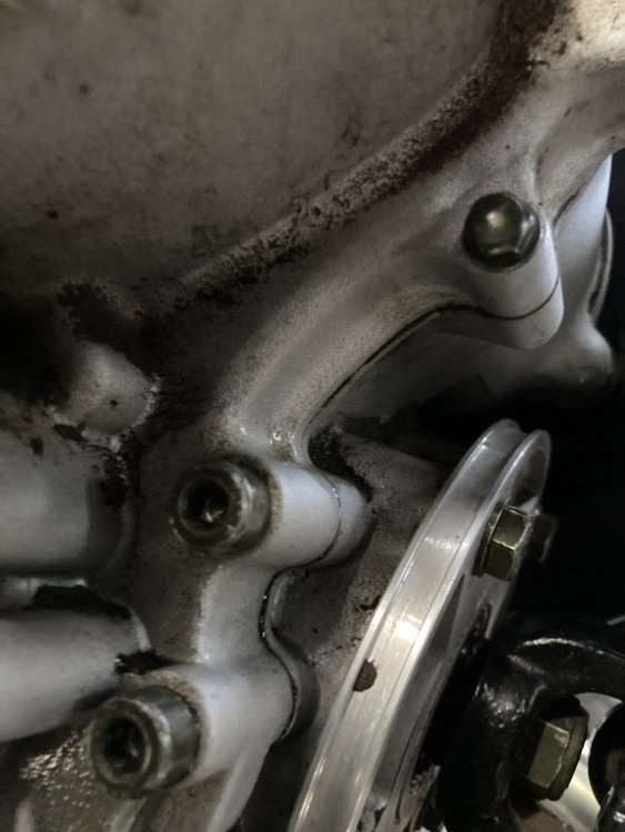

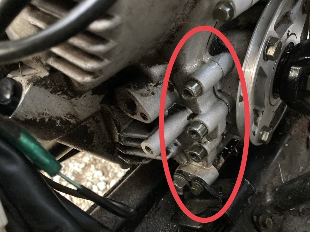

     I’m pretty sure this has been an ongoing issue even before I got it. Towards the front of the crankcase, right of driveshaft coming out I noted a lot of oil buildup. I cleaned it up really to see if I could identify where it was coming from. It looks like there’s a seam where the two sides meet and that’s where leak is originating from.
     From what I find in the service manual it doesn’t look like there’s a gasket here. So would anyone know how this seam prevents oil leakage? The next question is how would you correct this leak? I’ve read where you don’t want to use oil leak stopper as that will most likely cause slippage on your wet clutch. Any thoughts?

 since they didn't use a gasket most likely they used a RTV sealant (liquid gasket)
The only solution i can think of is to take it apart, clean both gasket surfaces with brake clean and Rubbing alcohol works good at removing that stuff. and a razor blade is good for scraping paper or RTV gasket off.
I prefer to use Permatex Ultra black sealer. good up to 500 degrees F, https://www.permatex.com/products/gasketing/ultra-series-gasket-makers/permatex-ultra-black-maximum-oil-resistance-rtv-silicone-gasket-maker-4/
And for any surface that comes in contact with Gear oil i use https://www.permatex.com/products/gasketing/gasket-makers/permatex-gear-oil-rtv-gasket-maker/?locale=en_us
