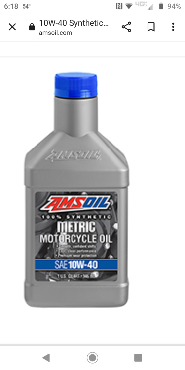

I got the hisun sector 550 with out the oil tube extension, when I change oil I don't empty the lines on oil cooler.
I got about 6000 miles on mine and add two quarts of oil when I change it and it is a little above the full line.
Over filling can cause damage on motor, causing seal's to blow from pressure I would think. Here's the oil I use and has worked well for my hisun.
Good information.  Mine is 2019 model, and it came with the extension.  I too use full synthetic 10-40 oil for wet clutch.
you have a lot of miles on yours.  Do you change oil based on hours or miles?  I change based on hours.  Thanks
