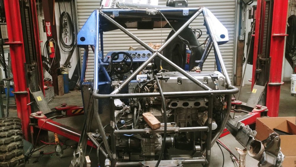

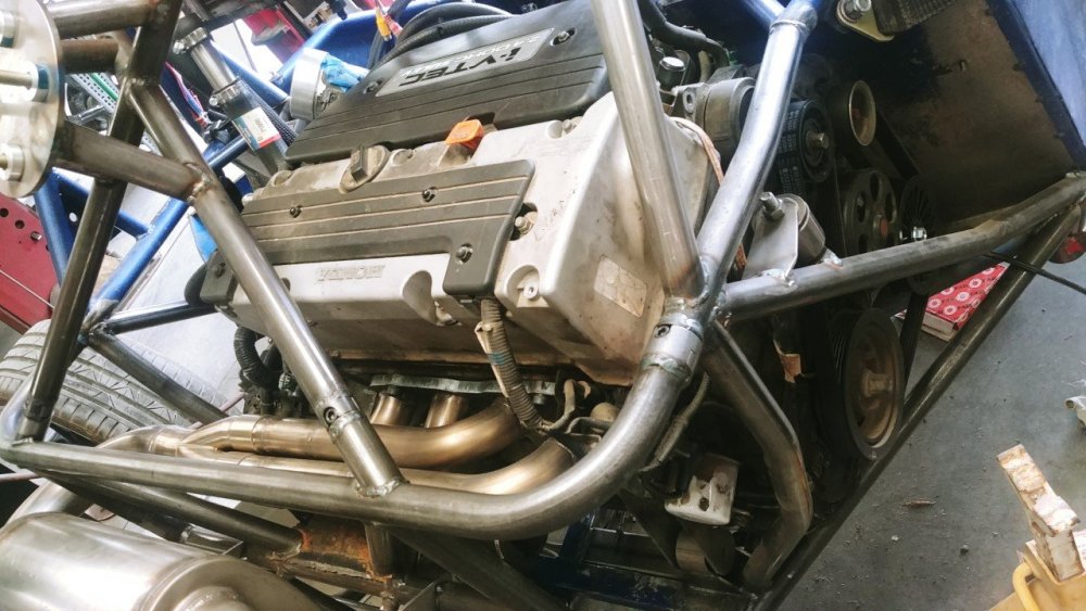

Hay gang It's been a long time since we posted. Here at West Coast Fabrication we are reworking the 1100 Joyner  installing a Honda K engine and trans, We will be posting a build program soon. At this time we do have a chery 1100 engine and trans for some one that needs it with long travel rear trailing arms no axles as they are already sold.

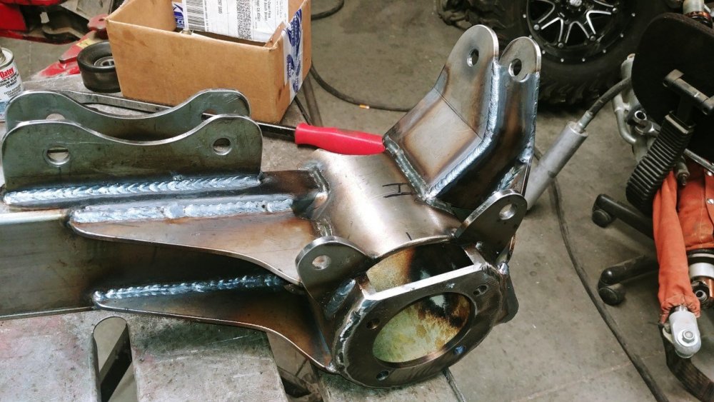

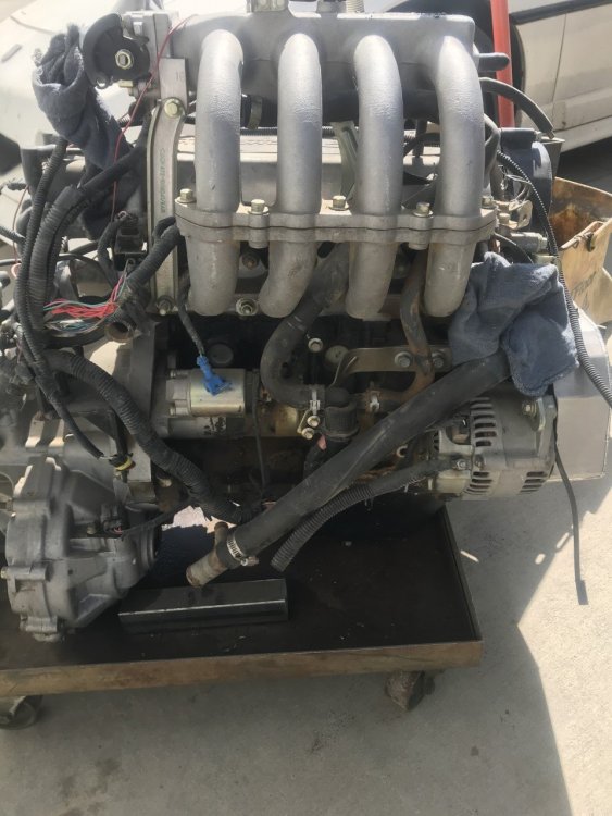

Still need axles They are being made at the Drive Shaft Shop in South Carolina. Working on detale assembly  today. Got some pictures for you guys.honda6.thumb.jpg.8b330742cf7af60ec79d1c6133cc12e7.jpghonda2.thumb.jpg.be5d3a29271ee928c53f56f50fa5e518.jpgHonda3.thumb.jpg.6bbdc4abc1f64b1a5c22492ca49a069f.jpg

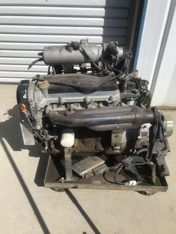

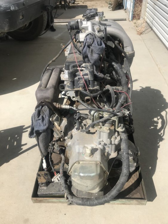

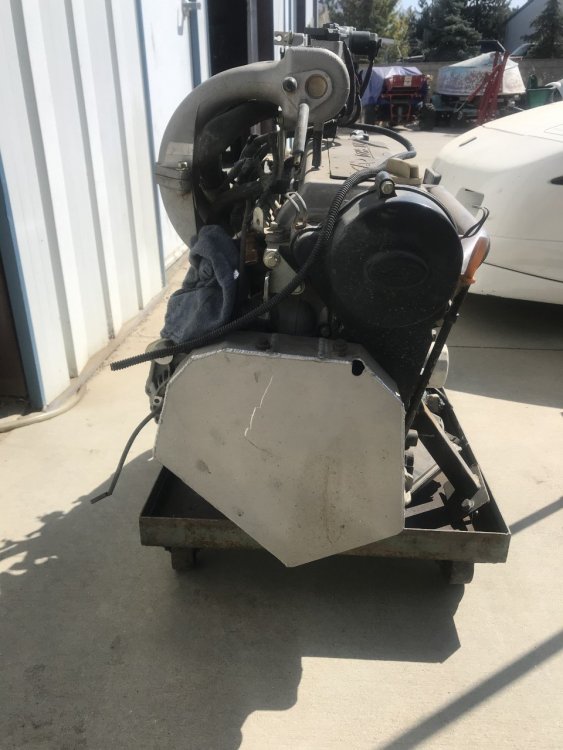

Thank you Chris from WCF i got this motor and trans to install in a buggy i just bought.  Chris was awsome a real great man and wanted to thank him. Instead of throwing the motor away he saved it and now gave it to me I drove 12 hours round trip but it was well worth his jenerosity. Thank You Chris
