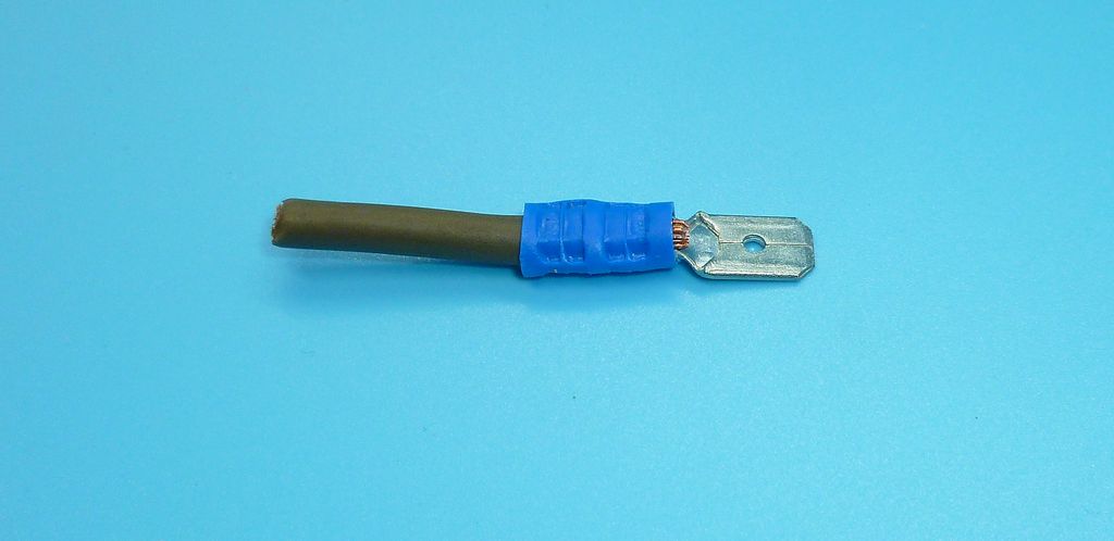

34 minutes ago, Travis said:
Heh, never knew crimping the end of those would help hold.
Learn something new everyday.
It was new to me less than a year ago--didn't know that plastic could be crimped...
