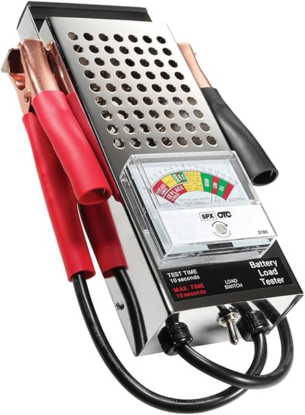

A good strong fully charged battery that is tested with this type of tester should read around 13.6 volts with no load and hold 12 volts under load, and return to 12.8 volta or more unless it has a bad cell or a bad terminal.
OTC 3180 100 Amp Battery Load Tester$37.xx on Amazon
Expand
13. 6 is what it should read with the engine running. It'll be significantly less sitting on the bench.

Did you see my post that i got the battery load tested?
It was perfectly in the Green
