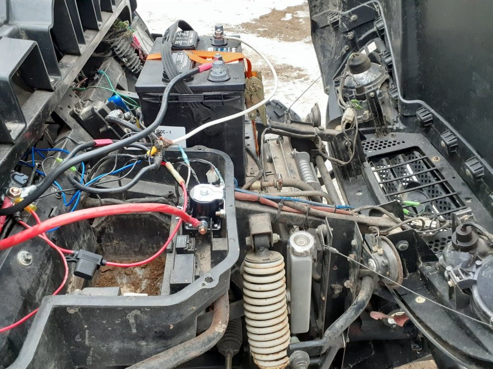

So, got it back from guy working on it.  I ended up mounting a deep cycle marine battery, in the center, battery supposed to be for it, doesn't want to start.  Runs but won't engage 4WD.  No matter which way button is.  Looking to sell it asap but would like the 4WD to work first.
Have you checked the button, to make sure it works? Next would be the relay (I'm assuming that it's electrically activated since you said button). Then there's the actuator in, or near the differential.
So, I have it jacked up but fronts don't spin (no matter whether I push button or not).  I had it unplugged at differential and tried to find voltage (volt meter) .  Saw nothing (unless I am doing it wrong).  Is there a relay for this?  If so, do you know which one it is?  Looking around battery box and see what appears to be several.  Googling it is not productive at the moment.
Simple 12v switches are weak. They don't have what it takes to handle any real type of load, like an actuator. So that's what relays are for.
So it's almost impossible for there not to be a relay to run that 4wd actuator. Which one it is, I don't have any clue. The good news is that they're usually all interchangeable. So while they won't interchange with the ones on your car, or truck. You should be able to switch them out with the others in the same fuse panel.
There's several ways to go about this. If you can find the wires at the actuator, and verify the same colored wires at the fuse panel. That'll tell you which one it is.
Or another way is to just find out if you have a bad relay period. By using the interchangeability to test in a known good circuit. Like the headlights, or horn, or winch. Pick a relay, pull it, see what doesn't work. Might take a couple of tries, to find one suitable. Use that circuit to test the other relays. Only do one at a time, put it back, move to the next.
Yea, the relays I've found (by battery box) all seem the same, except for the directional's.  Can't really chase wires from differential back, as they (for some reason) go under the unit.  No way to access them from there.  Unfortunately, the same colored wires (at differential) don't match any of the relay harnesses, so that makes it more of a challenge.  Will try swapping relays around and see what happens.  I have a local looking into it and may pay him to figure it out.
I've never seen a Qlink, but my understanding, is that it's a Rhino clone. There's plenty of information out about the Rhino. So if it's actually a clone, then the wiring would likely be more than similar. If not exactly the same. Since it's very unlikely that the Qlink manufacturer would try to fit the same components in, using a whole new floorplan. I think that it's a good bet, that the wiring would be the same as well. Might find some answers there at least.
So, I replaced all relays (because I couldn't find info on which one is for 4wd).  With UTV on blocks, the driveshaft turns but not the wheels.  Ended up buying a brand new snow blower and going to post this for sale.  Was hoping to have the 4WD working beforehand.
Well it's a process of elimination. Every component has to be individually checked. This takes time, especially when we do it through online media. But if you're willing to stick with it, we can do this.
Have you checked the actuator? They probably call it a servo. It should be a black box mounted to the back of the front differential. It'll have contacts that need to be checked, to see if they're burned. Next up, and the most likely culprit is the servo motor.

DIFF problem....you will have 2 connectors...one to switch power + to - and - to +......this runs the small electric DC motor that slides the rack (behind/under the black round shift servo) from left to right to left.  There are 3 positions.....2 WD, "3 WD" which is an open diff where if front end is lifted, the wheels rotate in opposite directions (with drive shaft locked) and then 4WD which locks BOTH fronts together.  Someone in the past has shifted into 4WD UNDER LOAD (and moving)....SNAP CRACKLE POP with emphasis on the POP.  DO the rack test (remove the black shift module....bolts here.....and slide the rack L to R to L.  Be aware that the position of the rack has to be "timed" to the servo unit.  Write down the dash switch(s) position (I like 3 WD) AND where exactly where the rack is sitting (in the middle slightly off center for 3 WD).  Test the servo by having another person run the buttons and you look for the gear to turn and motor to buzz.  The gear will go CCW and CW and CCW...exactly the way the rack should slide back and forth to select the desired function.  If the rack slides with no resistance from side to side...internal busted push pin on rack.  If working, the rack will move slightly and then stop because you have to rotate the wheels (spin the diff) to align the diff gears and then finish the "shift"  The servo has a "wind-up" spring between the electric motor drive and the gear output that "winds up".  What this does is put pressure (like you are doing with your hand) on the rack waiting for the gears to align.  There are contact tracks/Cu brushes (limit switches) that rotate with the drive reduction gears to send back 12 v OR open to electrically shut off the motor power so as to not bust up the works....winds spring up waiting for alignment....but not over driving the plastic gears.
