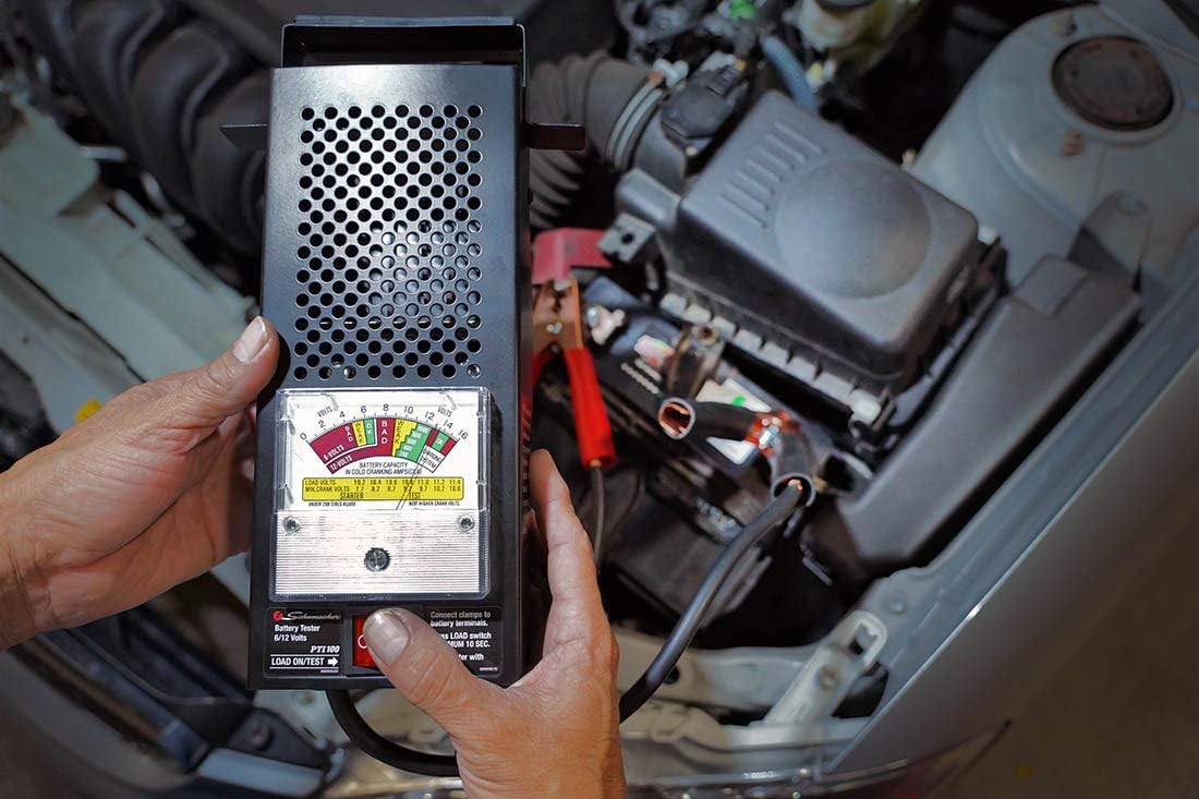

I ordered a battery of the right size and amps from Amazon. It is more likely you have a battery with a bad cell, one of these gave me a problem for two days, it caused me to tear down the body to get to the starter because my new tech battery charger gave a full battery reading but the starter acted like it was dragging. I had checked the battery for voltage with a multimeter, but finally hooked it up to a battery tester (One that can add a heavy load).  It showed under load only 6 volts. A new battery fixed the problem.
A Harbor Freight battery tester probably costs less than a 40 mile trip to WallyWorld (that is how far I am from a big town with a wallyWorld or a McDonalds.  Out here in the Boonies the RFD mail carrier delivers what Fedex or UPS don't. Then you don't have to wonder about that battery.
I have this one from Amazon
Battery Load Tester and Voltmeter"> Schumacher BT-100 100A Battery Load Tester and Voltmeter
Well, hooked up a load tester. It showed 12 volts before the load was applied. Once I applied the load, the needle fell almost as fast as it would if I was disconnecting the tester. Fell like a rock! Guess I'm in need of a new battery!
