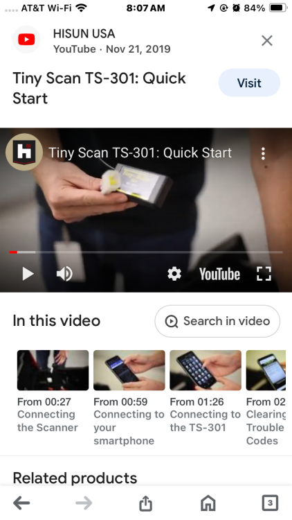

I have the TS 301 scanner and it does connect to the diagnostic connector found under the engine cover under the seat, but it does not have the soft ware to read the codes on the coleman 550 delphi computer. If Digital Technology ever gets the software I will try to get it

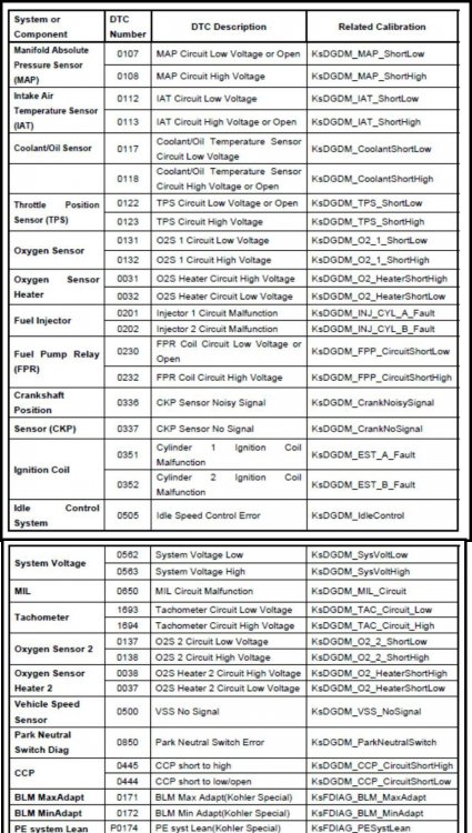

My 2020 Coleman Outfitter 400 claims to do this (though I've not had any problems to test it).
It's a pretty complete list (from the service manual):

Tiny scan 301 plugs into the hisuns, yellow cover on like a light looking plug

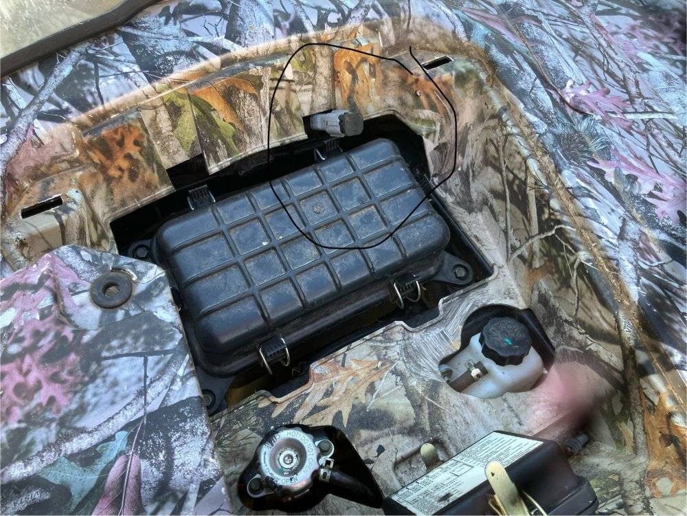

I just saw a video about the diagnostic port. Mine is a 2019 Coleman and he’s doing a hisun in the video but it looks like on the drivers side of the engine there is a connector. It isn’t connected to anything. The wires just lead to the connector and instead of say linking to another set of wires, this just stops. It has a plastic cover on it and you will need the hisun adapter. My Coleman 2019 550 shows a funny code every start up so I got a diagnostic tool. I never thought it would need an adapter for the jeep grand Cherokee in the driveway and a separate adapter for the Coleman UTV.
Edited by amiracle40995
Typing error
I just posted a video about 4 hours ago about where the diagnostic port might be. Then I was around my fuse box and noticed the apart diagnostic port? Poking thru in the picture I added with this post. My code reader doesn’t fit the plug in I’m seeing so I can’t say for sure it’s the diagnostic port but it looks like 1. Grey upper right in the picture IMG_0277.thumb.jpeg.552e6e1653120b49ff4bed035a3b67f1.jpeg
