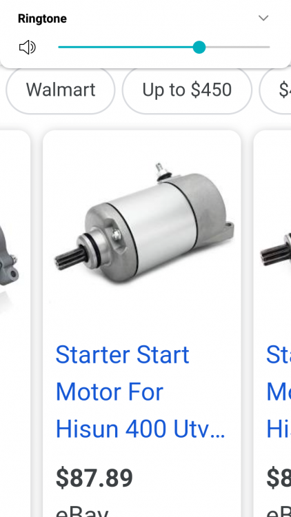

Checking the wiring is a good start. Checking the ground for a solid connection. Test the positive cable for resistance. Test the starter's amp draw. I'd suspect that it's a starter issue. Being the most expensive of the bunch to fix, I know that'd be my luck.
