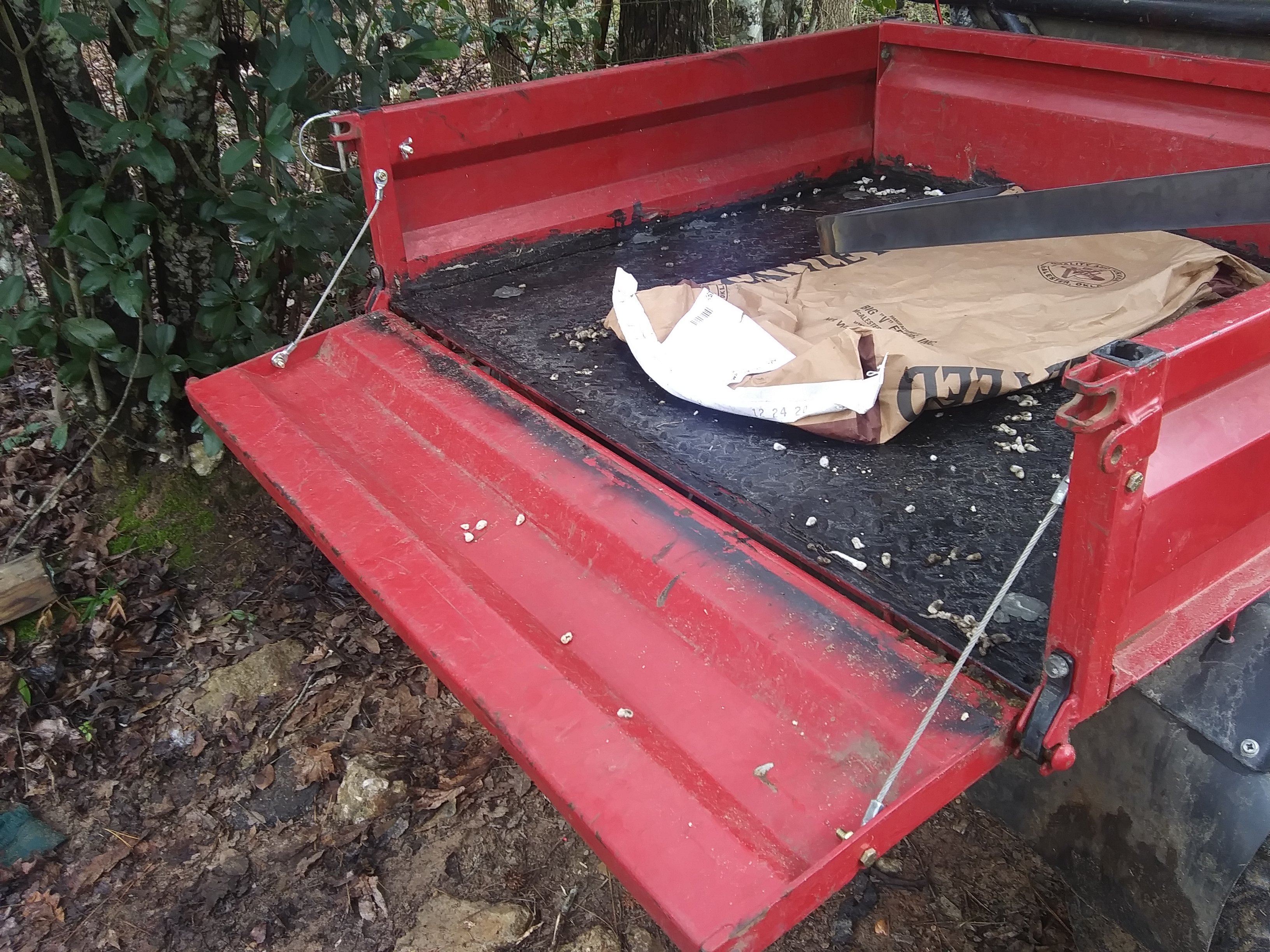

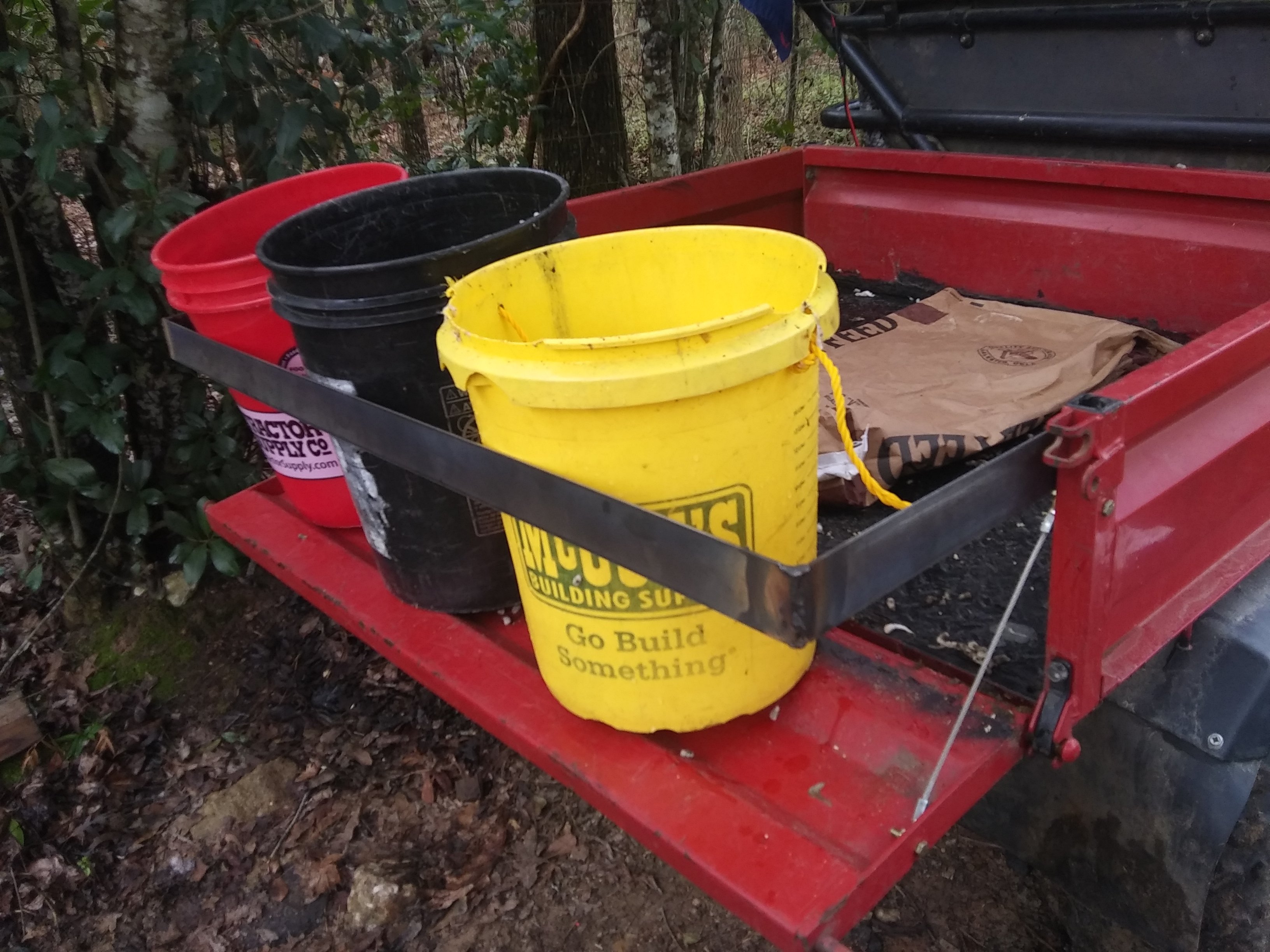

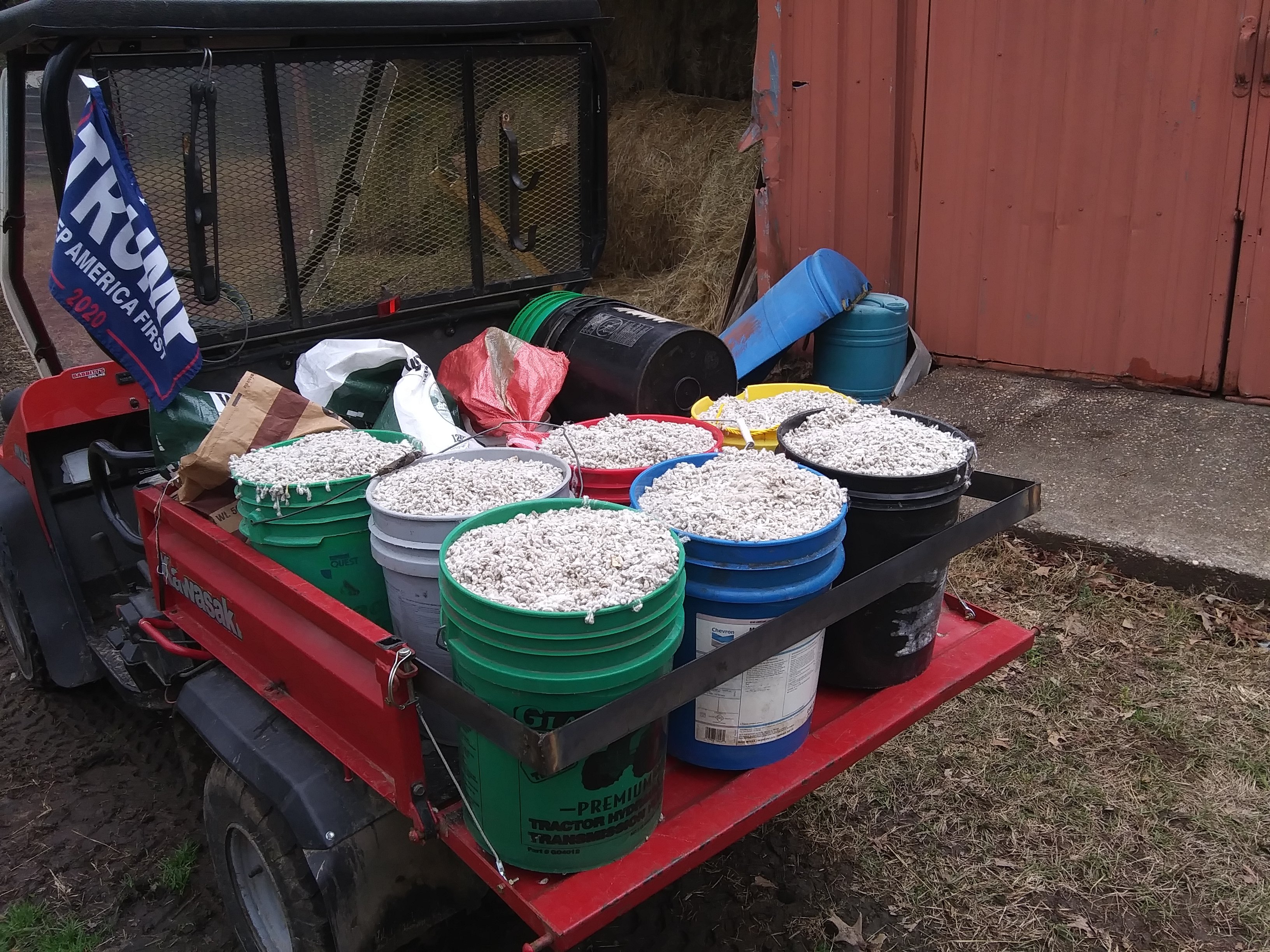

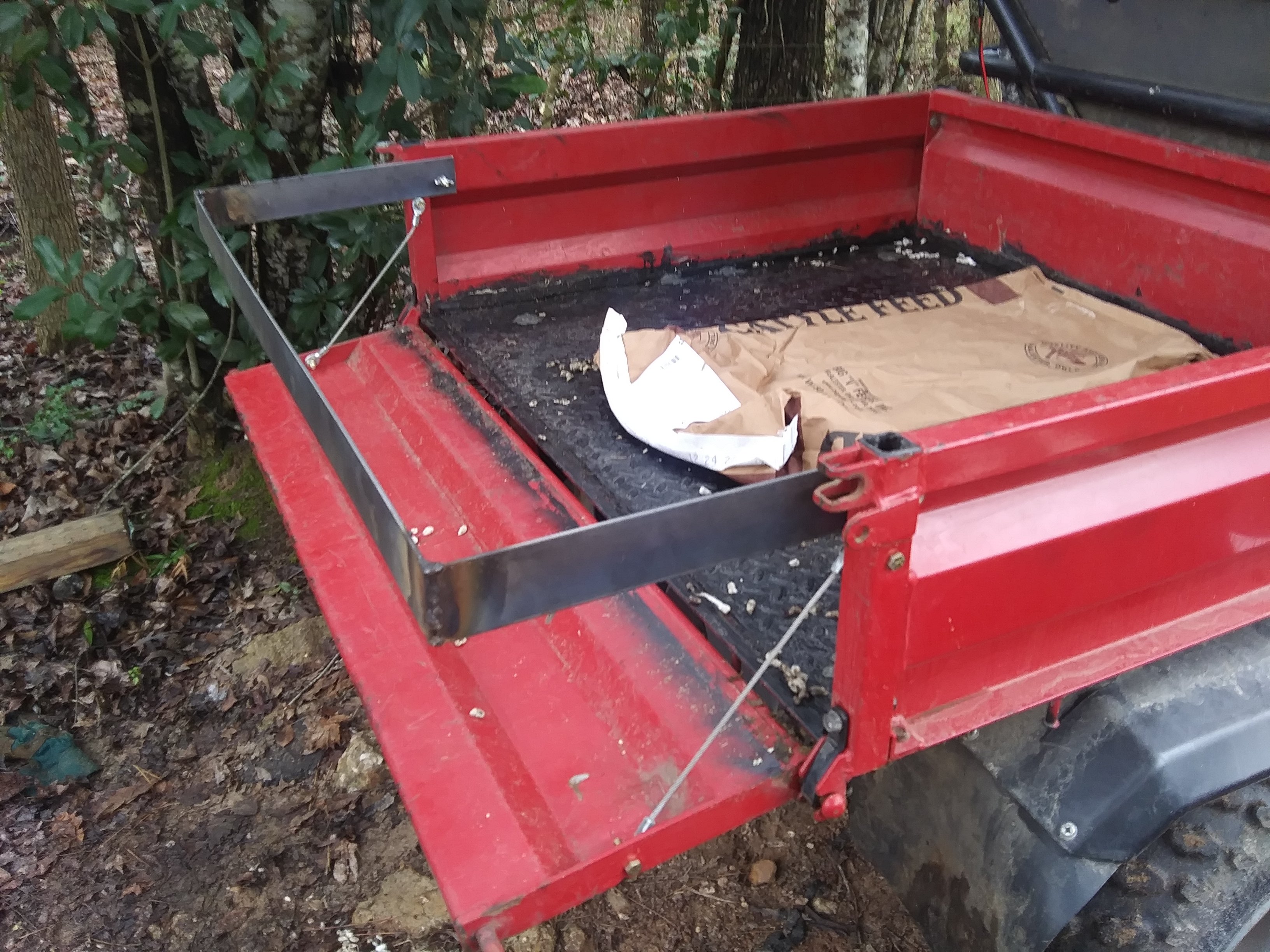

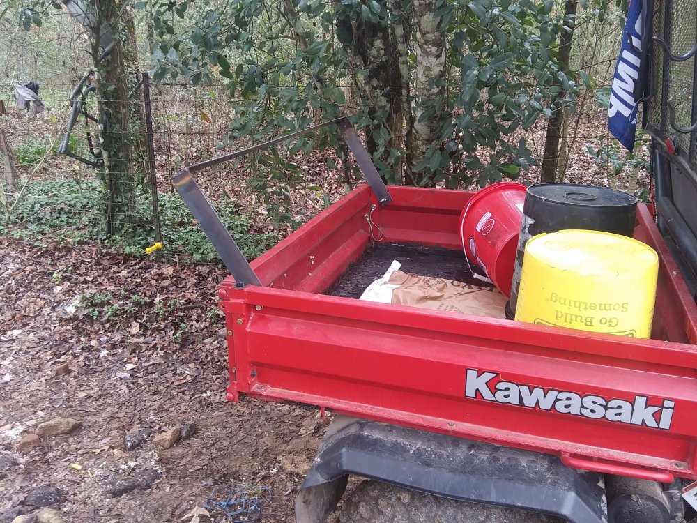

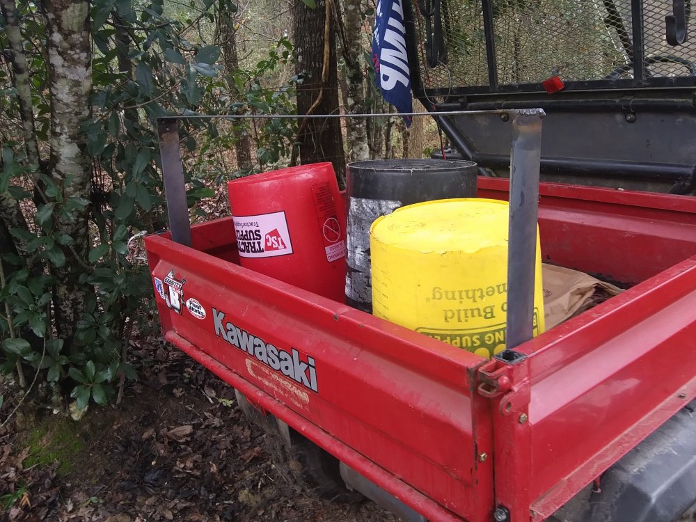

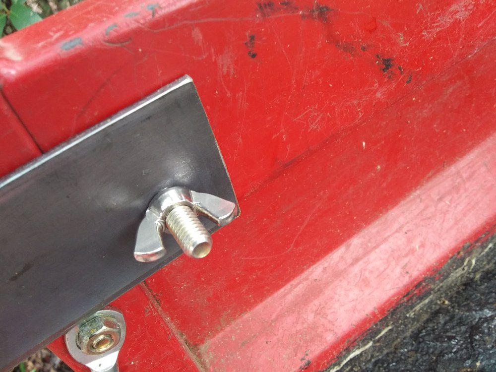

Hauling 9 5 gallon feed buckets is kind of tight for space in the dump bed, and if you need to carry a mineral block, extra feed and what not, that stuff won't fit in the glove the compartment!
So, here's what i devised.
i originally planned on having 2 simular pieces instead of 1, but i think this will do just fine.
the longest piece  is 40 7/8" and the 2 shorts are 13 1/2"
When not in use, either fold it straight up or it is easily removed in a few seconds by loosening the wing nuts, and then folding it up and tightening them by hand.
the bolts/wing nuts are through pre-drilled Factory  8mm (5/16") holes.
total cost is about $22 is flat stock 2 48" x1/8" x2" pieces, $2 for the wing nuts and bolts, and 1 welding rod and a half.
And of course, a welding job is not complete until you finish welding and you pick up the material where it's hottest......and drop it REAAAALLLLYY quick.
it also nice because the nuts for the tailgate cables and the holes in the side of the bed from the factory line up perfect so they also help support it.
Nice work, but I probably would've made it a drop in. Using square tubing, and the bed corner posts as a pocket. That way it could be stored out of the way, in the front corner tubes of the bed. Upright against the back "window", up against the screen. But as long as it works, it's all good.
Dang. You're too smart.

Interesting to see what is approved while we are mostly talking about UTVs. Nice mod I may use a form of. My wife collects bowling ball size rocks and you don’t want them moving around.
I would suggest milk crates for holding a rock, or anything that might roll around. They're more  easily secured too.
