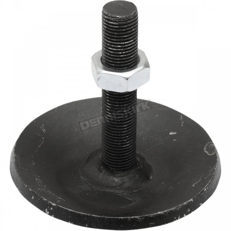

while we are at it on the topic of plows, i use a moose 5 ft blade............this year, i am having an issue with the blade pads breaking off............seems they are being made cheaper................lost two of the "mushroom" ends yesterday..........i just took them off until replacements come...........................anyone else have this issue..............i am mostly plowing 2 inch snows on concrete or blacktop driveways.............

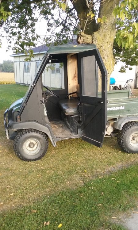

My cab is homemade wooden outhouse, 😅 quite drafty. Mr heater w/1# can on the floor helps but mostly makes my leg hot.
where's the hole in the seat? :D
If they are like these, I'd use a sleeve of 3/4" or 1" steel pipe as a spacer (once proper height adjustment is established) to distribute and shift the load away from the stud and weld.

I haven't broke one of those on my Eagle or KFI plows, I did lose a few bolts that holds the blade on on the Eagle plows
