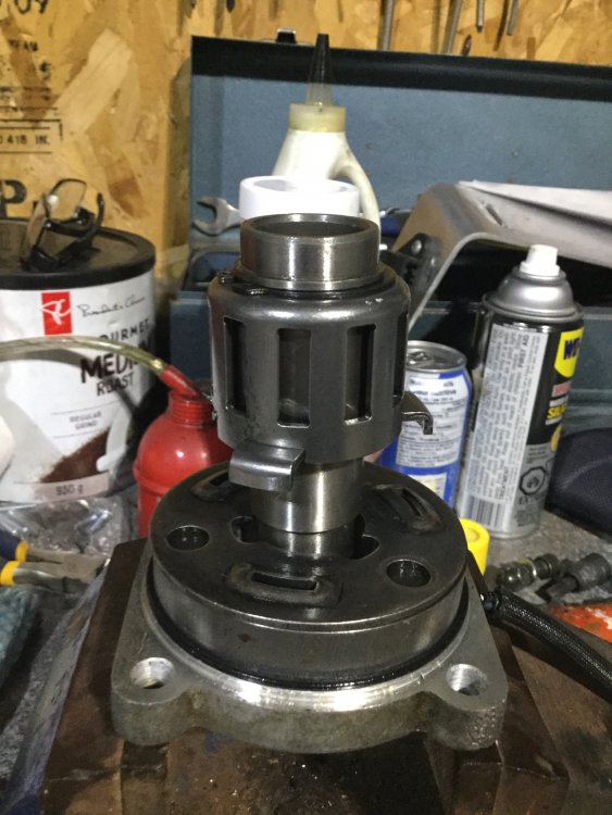

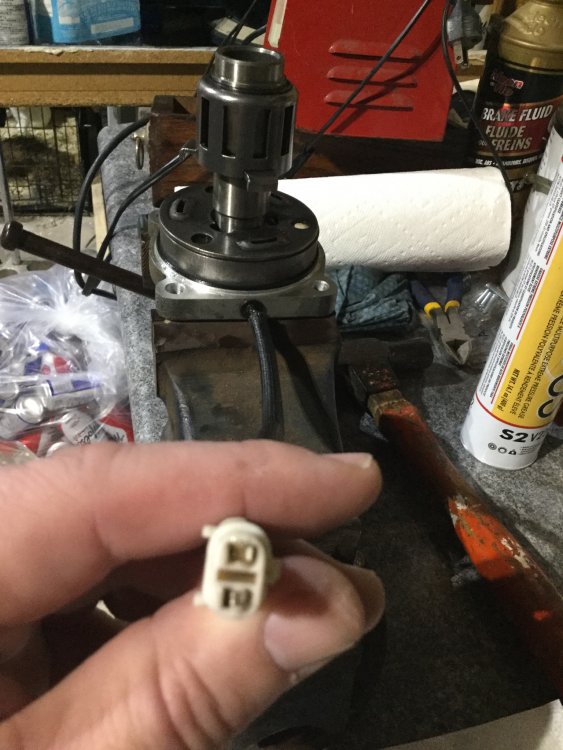

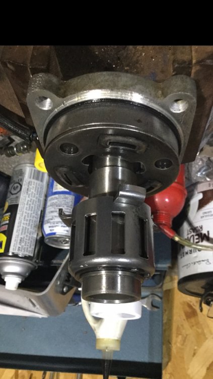

So this is what is preventing me from switching from 2WD to 4WD.  Anyone what this is called?  It’s magnetic and basically sticks on the differential to activate front wheels and disengange when pressing button to go back to 2WD.  Looking to buy the part but not sure what it’s called. Tia

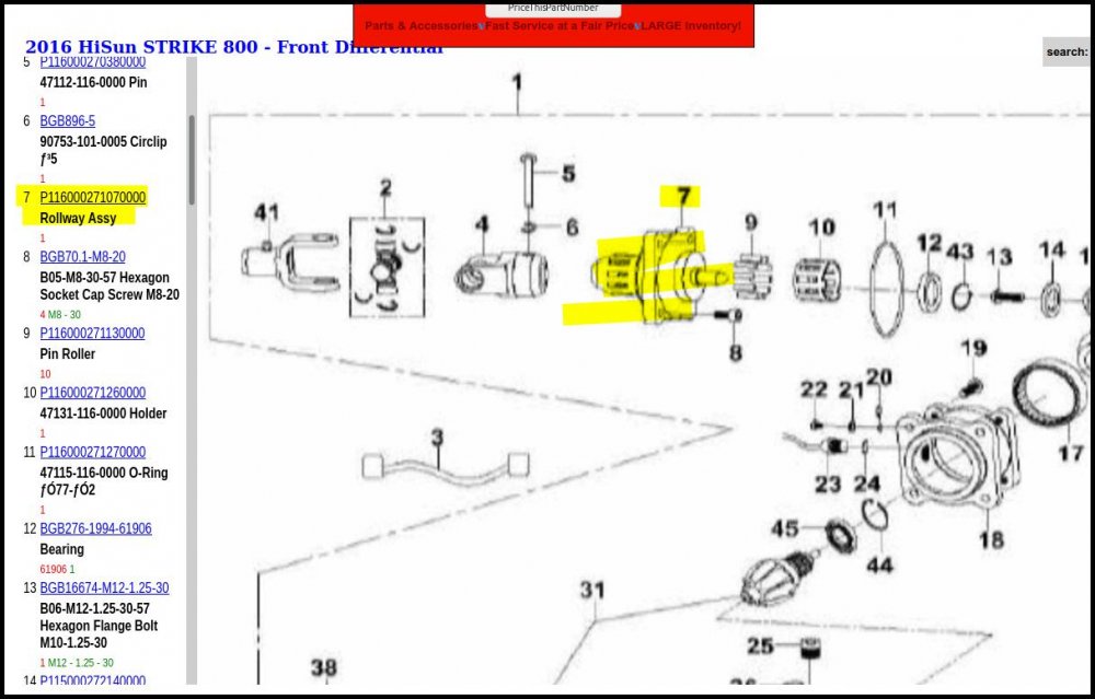

It would appear to be a  front "Rollway Assy" (a magnetic clutch of some sort) ) as used in a Strike800 and other similarly sized models.  $235 from alpha-sports.com. (I'm a retired mechanical engineer, research is a big chunk of engineering)...
