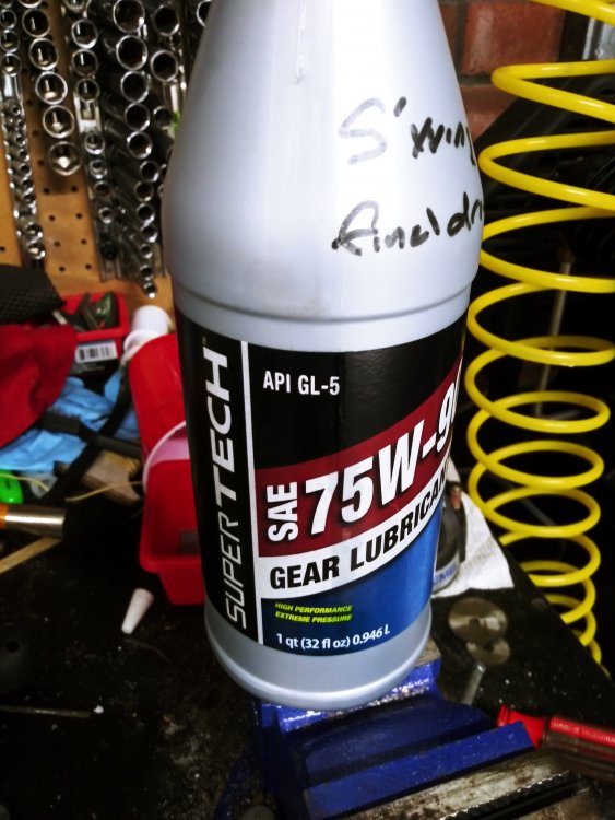

I just changed the gear oils in my 2020 Outfitter 400  a couple days ago--used Supertech (Walmart's house brand) 75W-90 GL-5 gear oil, which is made by Valvoline--Its what i  used it in my 2003 515 HP 2003 Mustan g Cobra, thatr's why there was a nearly full  bottle on the shelf in the barn..--use it in my 2009 Honda Silver Wing too. Heck, I'd use it in anything without hesitation...
