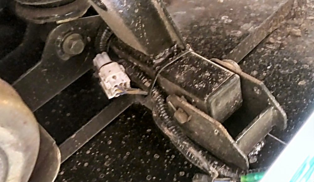

Anyway, there are two initial things on the UT400 I'm not sure what they are or for.  The first, there is a square white electrical connector with about 8 pins hanging form under the middle of the back bed - I don't see another one to match up or plug into it, so wondering if this is pre installed optional connection for like towing around a sprayer?  Anyone know what this is?  Also, there is a 10 inch black rubber hose that is zip tied to the back A frame on the passenger side.  I watched the assembly video and it doesn't mention one, so don't know what this hose is for - anyone know?

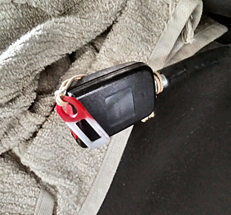

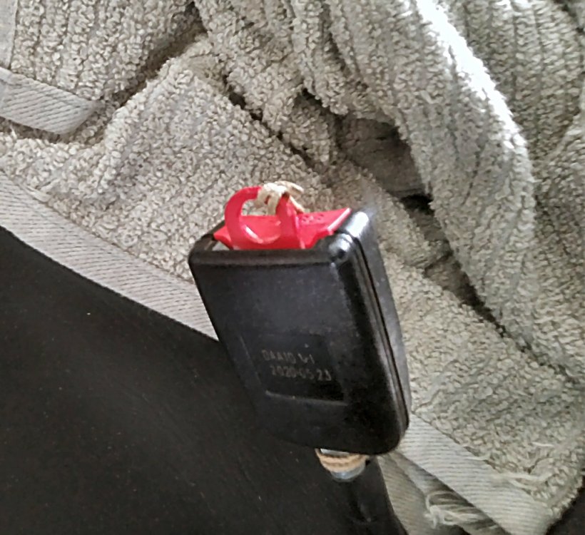

Also, has anyone come up with a "fix" or work around for having to have the seatbelts plugged in or even in place?  We aren't planning on using them and are figuring just plugging them in and wedging them behind the seats - didn't know if there is a way to just disconnect the "over 10mph gas starving" safety sensor.

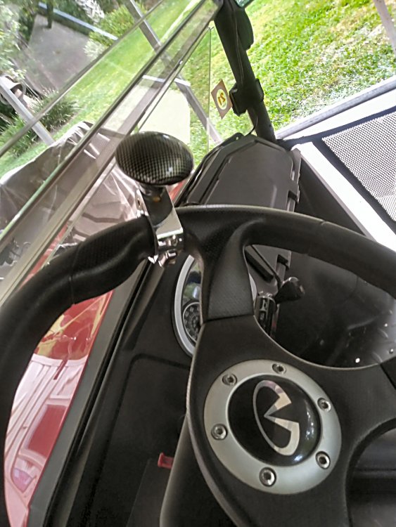

Looking forward to seeing how this machine does for my father.   I'm thinking about installing a suicide knob on it for easier turning for him, as it's a little stiff (compared to our Kawasaki Mule).  Maybe with use it will loosen up some?

I think the connector you refer to is the taillight plug--does it look like this?
The harness from the lights plugs into it.

Re: the seat belt interlock, I have devised a "thingy" that plugs into the seat belt socket and tricks the computer into believing the seat belt is connected:SeatBeltThing-00.thumb.jpg.e1bdc3b85cfad60d1a220e028f14e266.jpg
I'll send you a PM with my address, send me a SASE and I mail a couple out to you.
I have a suicide knob--wouldn't be without it:
