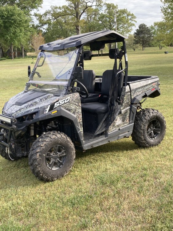

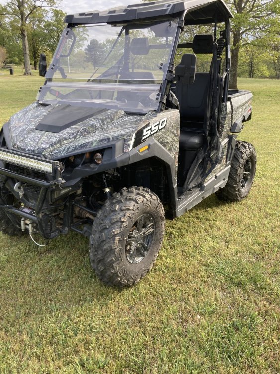

Thanks for the reply. I ride a handful of times a year in the Ozark mountains where I constantly have issue with big rocks hitting the skid plate and a few off camber situations. My plan is to only run the bigger tires and spacers for these rides and keep the stock wheels as is for around the house applications.  I feel like it will hold up for 40-50miles at a time 3-4 times a year. Just seeing if anyone has issues or experience with these
Update. Installed 27x9x12 in front and 27x11x12 in rear. No spacer required to gain clearance and  no noticeable impact to steering/ handling. Slight impact on stopping power at higher speeds. Did gain 1 1/2in extra clearance in front and back. I’ll update as issues arise that I feel relate to this.
PICTURES  dude c'mon man
Definitely notice the width difference.  Did you have to remove the side rock guards for clearance or did yours not have them?  Like the light bar too - just finished putting  an extra set of led cubes I had sitting around on mine last night.
