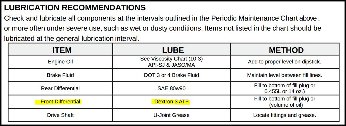

Howdy y'all,
1)  It is time to change the diff fluid.  The service manual says 80w-90 for the rear and Dextron 3 ATF for the front!  Is that correct?  That seems odd to me.
2) The service manual also speaks of the need to change the transmission fluid but gives no detail about it.  What needs to happen here?
3). The service manual also discusses changing the final drive fluid with 80-90 Hypoid.  Is the final drive actually the tranny?
Thanks,
Craig C.
The latest SM for my HS400 (Coleman UT400) also states using Dexron 3 ATF (Dexron, no "t", the "t" is a common misspelling) in the front differential.
from the latest Hisun HS400UTV-5 Service Manual:
I have confirmed with Hisun that this is correct--ATF is used in many gearboxes, not just automatic transmissions. It is VERY heat and wear resistant (it has to be to survive the clutches and planetary gears in an auto-tranny) --the Tremec TKO-500 transmission in my 2003 500 HP Mustang cobra used Dexron 3. I suspect in the Hisun front-end it may help the 4WD/Differential Lock mechanism work more smoothly (on my 400 the shift in and out of 4WD and "lock" sometimes requires a quick "jerk" of the accelerator.
I changed my front diff to 85W-90 SAE GL-5 at 20 hours use as I had not yet received the latest service manual, but at the next change it gets Dexron 3...
The "final drive" is the rear axle gearbox. The transmission is in the crankcase lubricated by engine oil (that's why it's IMPORTANT to keep the engine oil clean).
BTW, the rear axle gearbox is not a differential--it is a "spooler", equal power to both wheels , the narrow track makes that possible (at the expense of tire wear)--but it is also why traction is so good in 2WD...

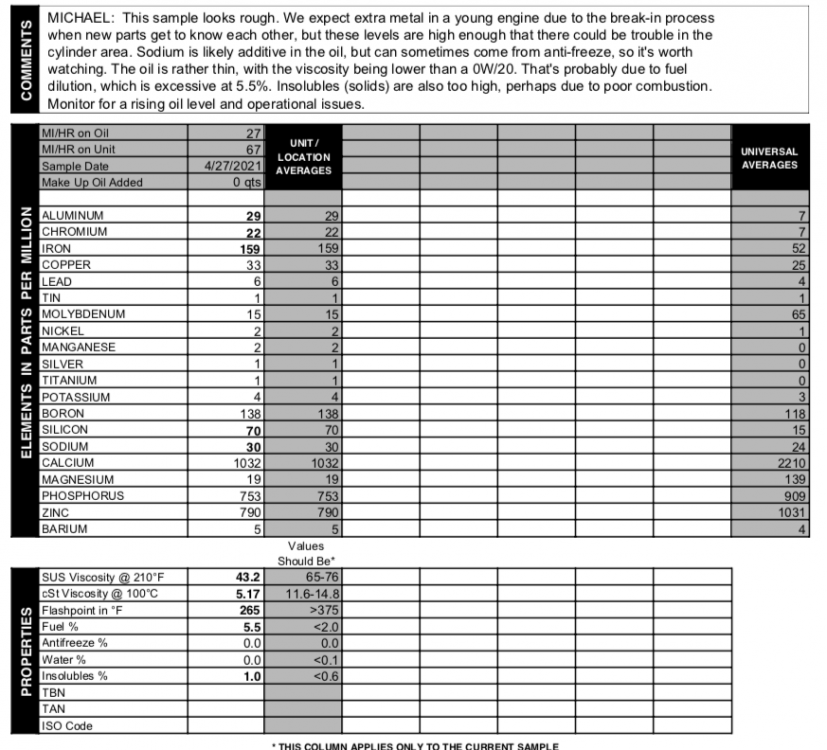

Most concerning ... 66 hours.  I went ahead and changed the oil for the 2nd time.  I changed it at 39 hours the first time.  Mobil 1 10w-40 4T.  With only 27 hours, that sh*t was nasty.  I could not believe how blackish gray it was and gritty.
Is this what y'all are seeing?  Not sure this is the mark of a good running engine?
I sent a sample to the lab (Blackstone Labs).  Not sure I want to know the results.

Got the oil report back.  Not good.  27 hours on the oil.
