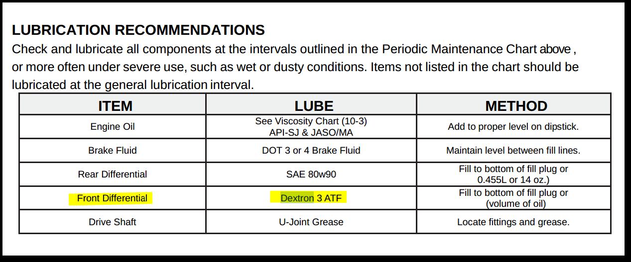

In a recent thread fellow forum member mcraigchr asked about Hisun's recommendation to use Dexron 3 ATF in the front differential--I had noted that in the latest SM I received for my HS400 (a "UT400"as labeled by  Coleman) that was also the recommendation. AS it was in conflict with other information in the manual I contacted both Coleman and Hisun who both verified the recommendation.
from the HS400 SM¹:

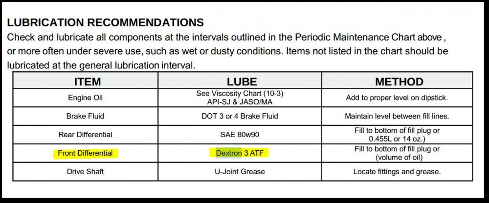

from the HS550/750 SM¹ (same table obviously):
I did not find this at all odd, as ATF is used in many high torque gearboxes and manual transmissions--it is VERY heat and wear resistant with additives intended to protect the sliding contact of helical gear sets as well as excellent protection for ball bearings, and bushings.

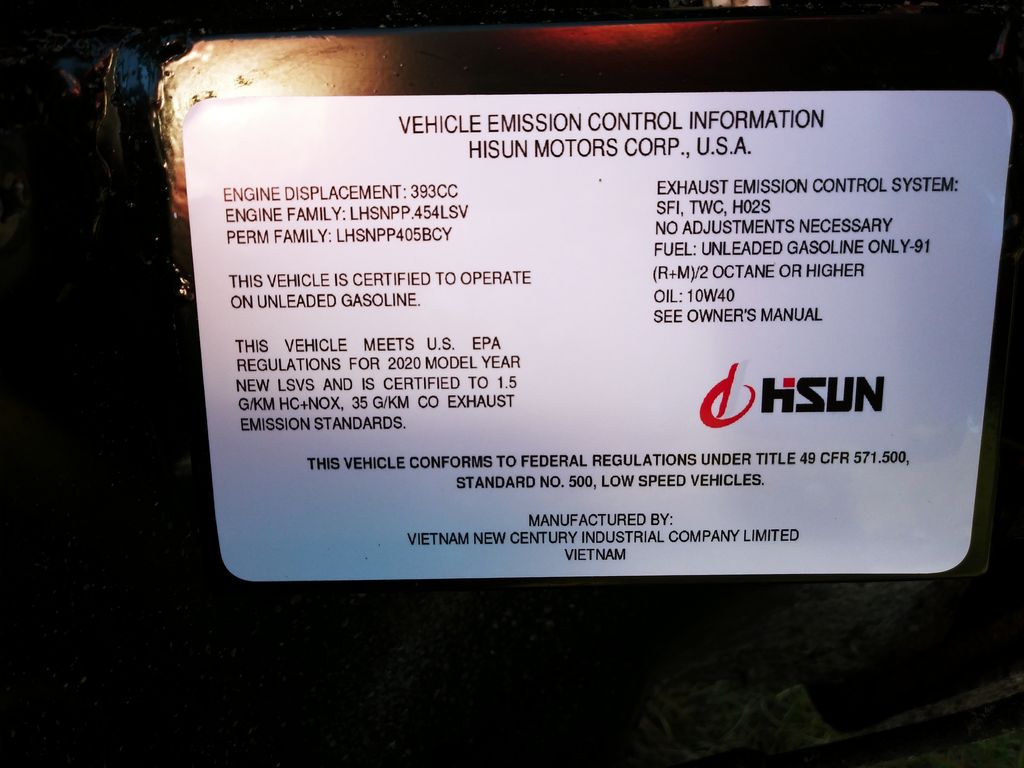

The MSU400 (which is a re-branded Hisun HS400) probably--the Buck 400 maybe not. After Hisun (Chongqing Huansong Industries (Group) &nbsp;Co., Ltd.) cut Massimo loose for poor customer service in 2018 they scrambled to find other suppliers--according to the EPA emissions certification database the 2018 through 2020 Buck 400 was made by the Taizhou Nebula Power Co., Ltd.  (<-- this is a link to their Alibaba presence, probably where Massimo found them).
The EPA certification sticker on your Buck should tell you who made it:
You need to check with Massimo...
