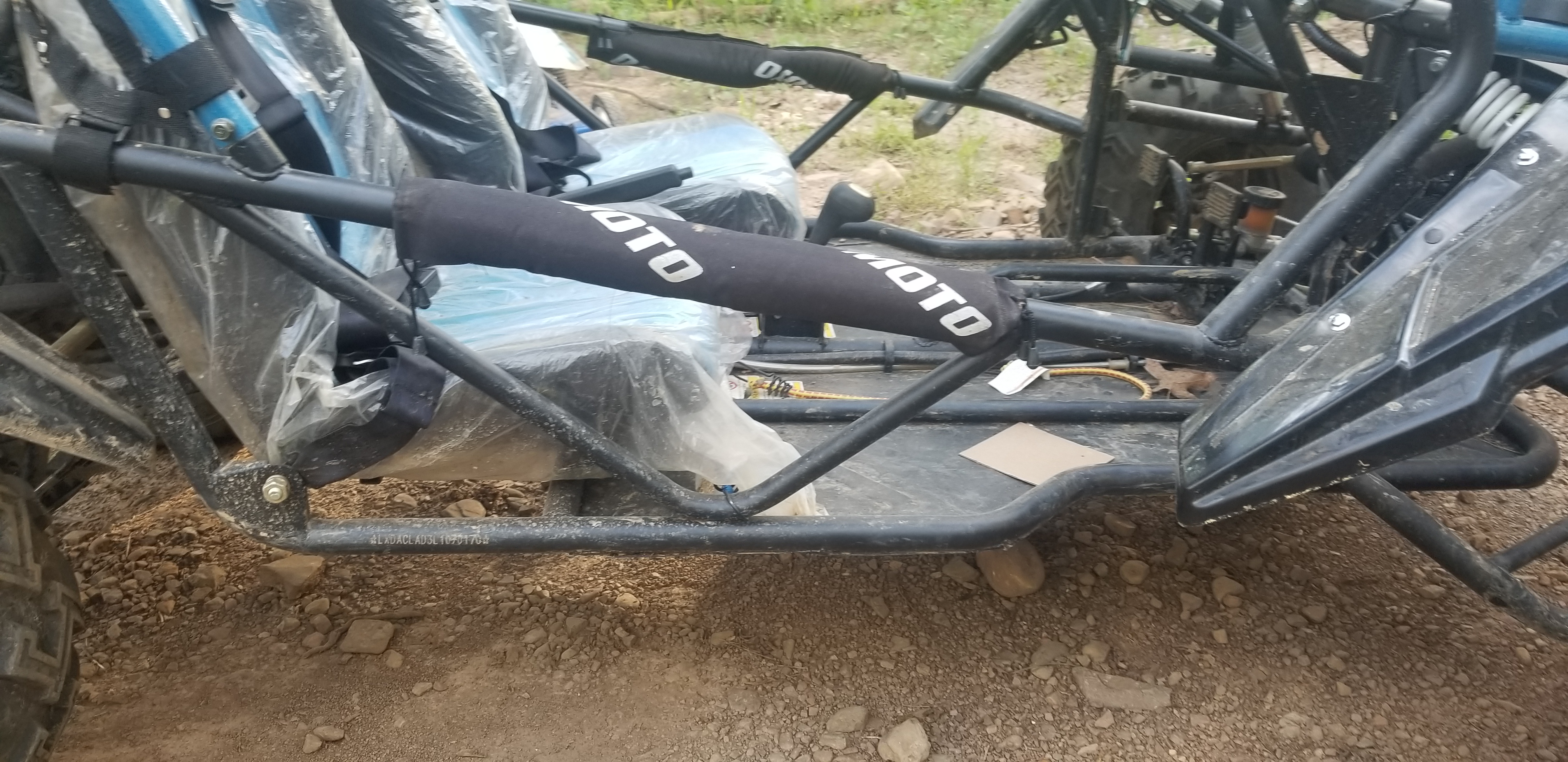

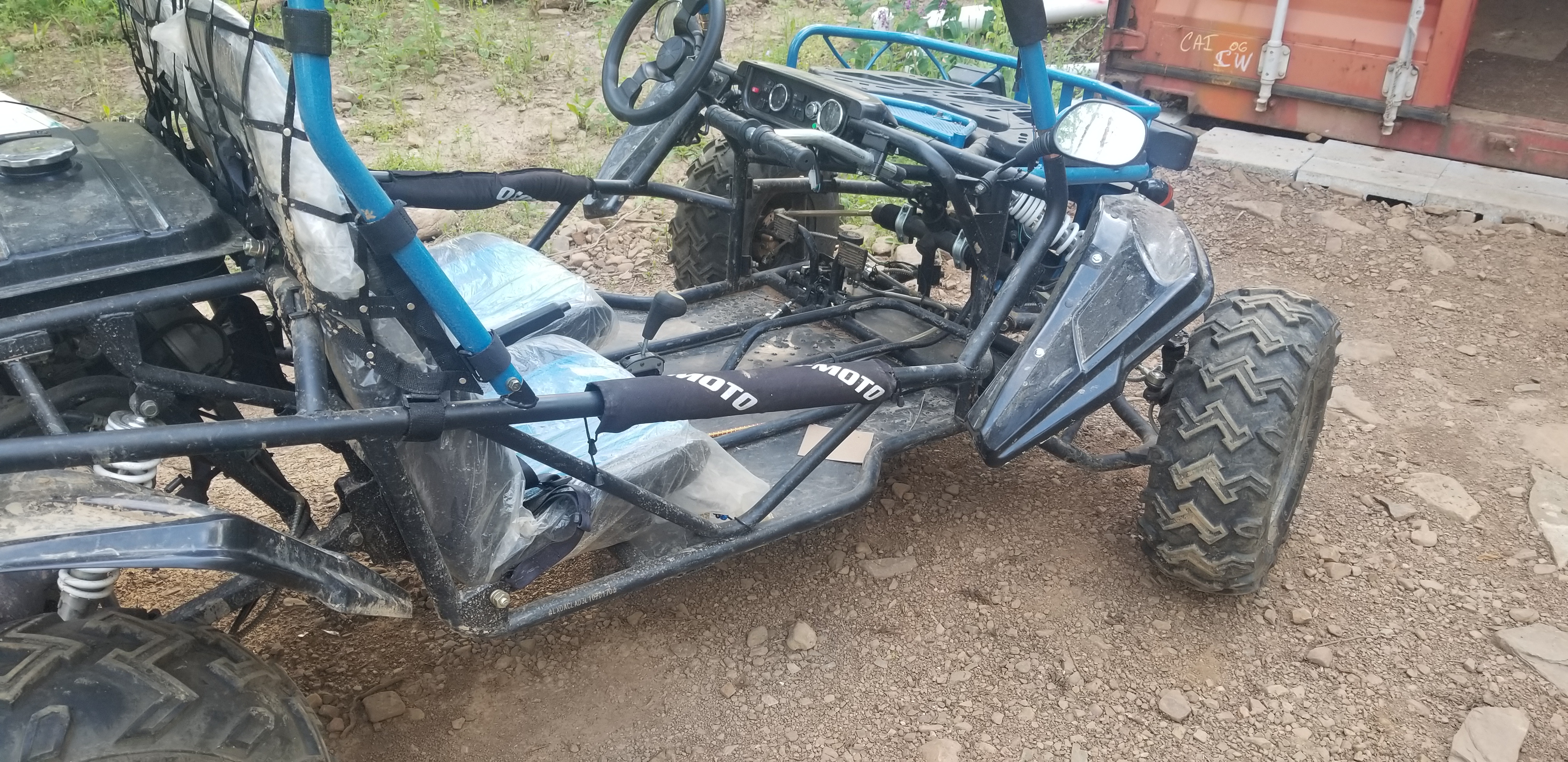

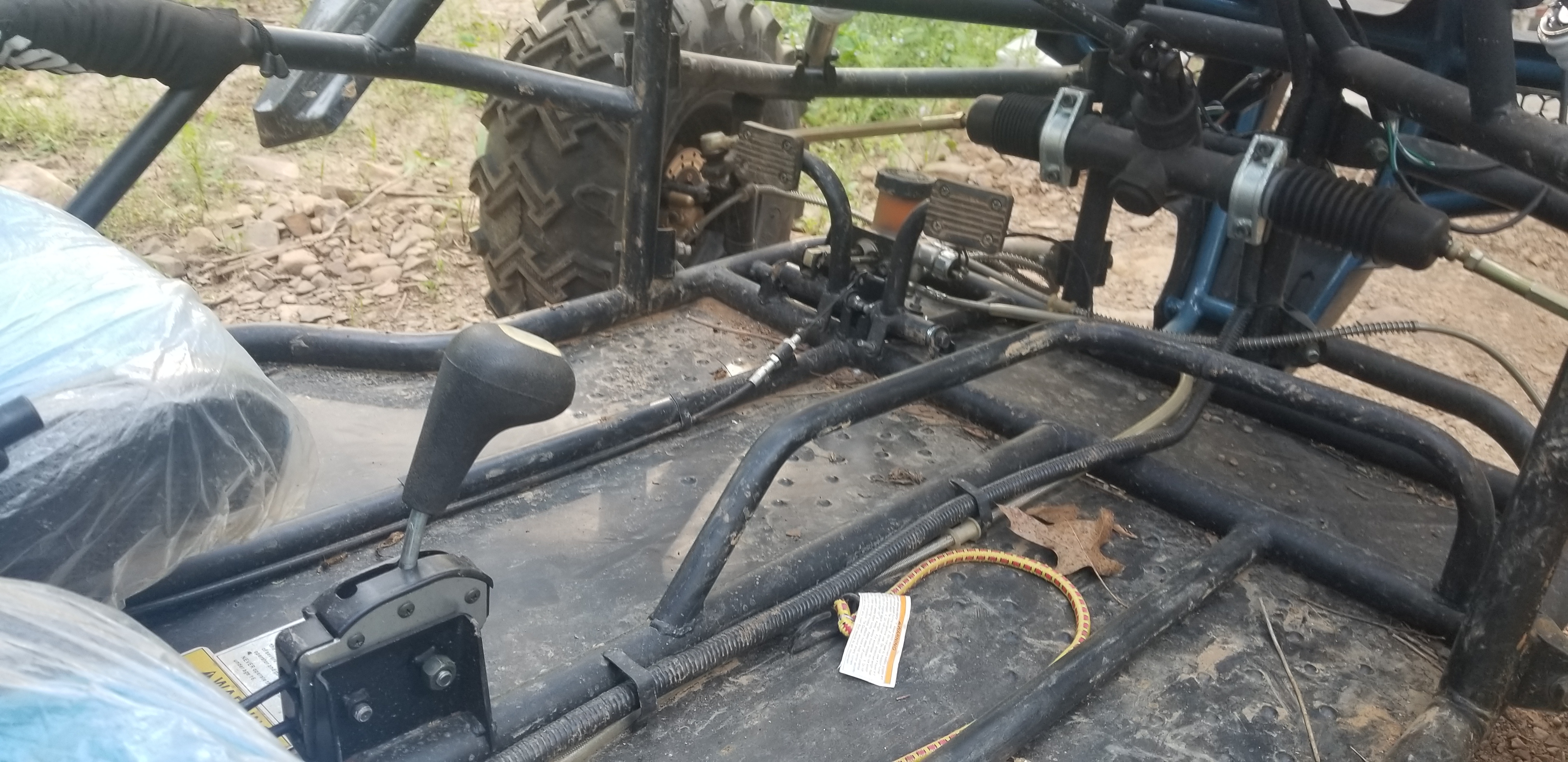

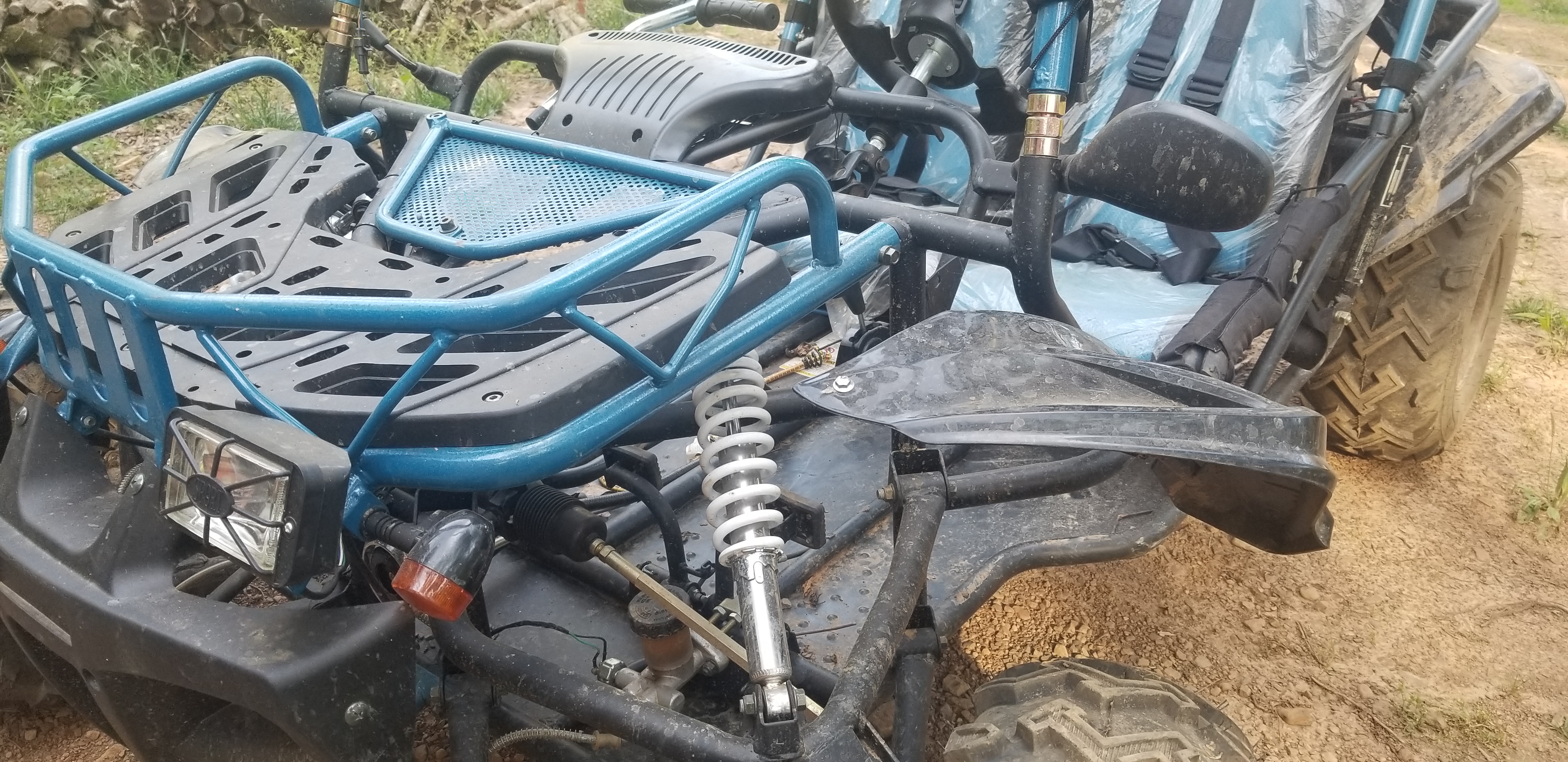

So my neighbor gifted my wife a Chinese UTV, I got it running again with a new battery and carb.  The wife loves riding it EXCECPT, when its wet or muddy.  Our area in SE OK has creeks all over.  Well she asked if I could put body panels on it, like the name brands have.  I have searched high and low for pre-made and all  find are fenders, and nothing searching for DIY except fenders..  Anyone here made side panels for a Chinese UTV?   The way the frame is made I cant see any easy way so may have to add some tubing but wanted to see of there are any I could see to figure this out.

I took 18 wheeler mud flaps and cut them with a razor knife and attach to existing parts and panels on my unit. Most people that see the. Think they are factory. I just made sure I kept round smooth edges that didn't draw much attention. The bottom of the flap i tried to cover as much area to block the mud etc that flies at you. This helped alot with dust and even noise. Hope this helps.
