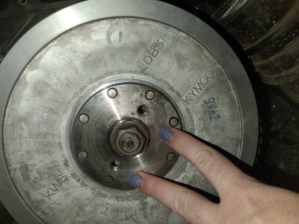

We took secondary clutch off threaded the 2 holes and ran bolts in spread it put belt on it and then over the primary (primary will not have to come off) as we put the secondary on. Spin clutches a few times by hand to get belt to set properly. Makes it way easier and can not be done on the trail if needed as long as you have a few tools.  See picture for the holes that we threaded.
3/8 tap works perfectly if you go this route.
