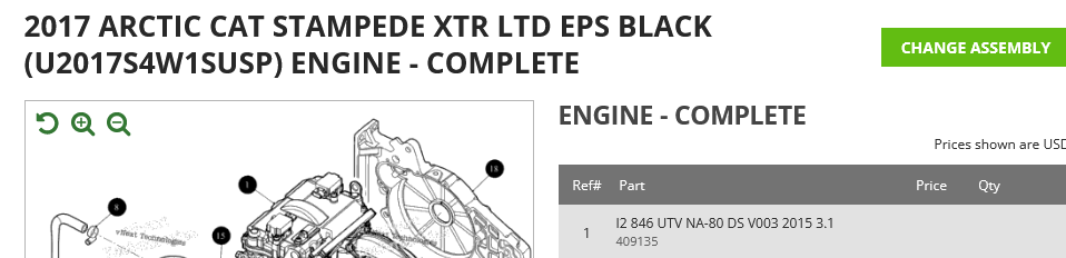

I found the part number of the engine, and according to partzilla the engine only fits these models
This Arctic Cat 409135 I2 846 UTV NA-80 DS V003 2015 3.1 fits the following models and components:
Arctic Cat Side by Side 2017 STAMPEDE LTD EPS INFERNO RED - U2017S2W1SUSN ENGINE - COMPLETE [302495]
Arctic Cat Side by Side 2017 STAMPEDE XT EPS BLACK - U2017S1W1SUSP ENGINE - COMPLETE [302495]
Arctic Cat Side by Side 2017 STAMPEDE XTR XT EPS FOREST GREEN - U2017S3W1SUST ENGINE - COMPLETE [302495]
Arctic Cat Side by Side 2017 STAMPEDE XTR LTD EPS ELECTRIC BLUE - U2017S4W1SUSU ENGINE - COMPLETE [302495]
Arctic Cat Side by Side 2017 STAMPEDE LTD EPS BLACK - U2017S2W1SUSP ENGINE - COMPLETE [302495]
Arctic Cat Side by Side 2017 STAMPEDE FOREST GREEN - U2017STW1TUST ENGINE - COMPLETE [302495]
Arctic Cat Side by Side 2017 STAMPEDE XT EPS INFERNO RED - U2017S1W1SUSN ENGINE - COMPLETE [302495]
Arctic Cat Side by Side 2017 STAMPEDE XT EPS BRIGHT WHITE - U2017S1W1SUSB ENGINE - COMPLETE [302495]
Arctic Cat Side by Side 2017 STAMPEDE XTR LTD EPS PLATINUM - U2017S4W1SUSV ENGINE - COMPLETE [302495]
Arctic Cat Side by Side 2017 STAMPEDE LTD EPS PLATINUM - U2017S2W1SUSV ENGINE - COMPLETE [302495]
Arctic Cat Side by Side 2017 STAMPEDE LTD EPS ELECTRIC BLUE - U2017S2W1SUSU ENGINE - COMPLETE [302495]
Arctic Cat Side by Side 2017 STAMPEDE XTR LTD EPS BLACK - U2017S4W1SUSP ENGINE - COMPLETE [302495]
Arctic Cat Side by Side 2017 STAMPEDE XTR XT EPS INFERNO RED - U2017S3W1SUSN ENGINE - COMPLETE [302495]
Arctic Cat Side by Side 2017 STAMPEDE XT EPS FOREST GREEN - U2017S1W1SUST ENGINE - COMPLETE [302495]
Arctic Cat Side by Side 2017 STAMPEDE XT EPS REALTREE X - U2017S1W1SUSF ENGINE - COMPLETE [302495]
Arctic Cat Side by Side 2017 STAMPEDE XTR XT EPS BLACK - U2017S3W1SUSP ENGINE - COMPLETE [302495]
Arctic Cat Side by Side 2017 STAMPEDE XTR XT EPS REALTREE - U2017S3W1SUSF ENGINE - COMPLETE [302495]

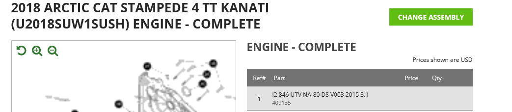

16 minutes ago, Travis said:
However, if i look at the parts list for the 2018 4 seater..... they use the same 409135 engine.....
2017
Great job Travis! It certainly sounds good so far.
Although it still needs more verification, I feel very good about it being a drop in replacement. But I'd certainly want to at least get the factory CPU that came with the donor  motor. Preferably i'd want unlimited access to the whole vehicle.
