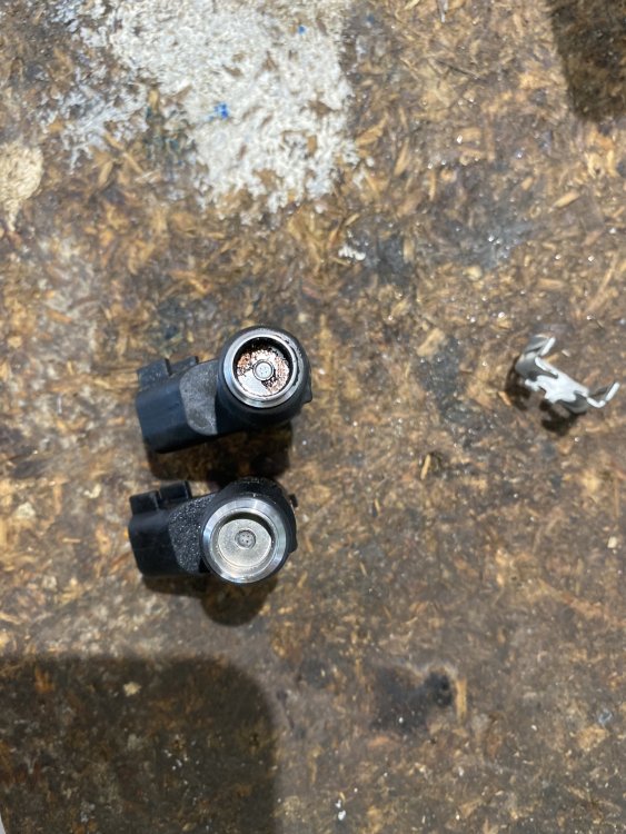

As far as your EFI issue, these machines are meant to run on 93 premium fuel that is ethanol free, most owners don’t realize it or don’t want to pay the higher costs. Then they let the unit sit for an extended period, most times I find the fuel injectors actually rusted. Best bet is change the injectors and run premium fuel.

 I apologize for taking a while to get back to you, Fall projects have kept me away from my SxS project. I thank you for the heads up about the fuel, I had been made aware of this by another person. I got this as a basket case so the type of fuels not been an issue so far. I have tested and the injector power supply and that is ok but testing for any fuel output shows No fuel comes out as either a spray or stream. I have replaced the injector and the ECM module and not having any Diagnostic equipment beyond a Volt meter I am about to replace the O2 unit as this is listed as one of many possible failure points for the EFI system. I'll post if I start to make any gains in this project.
