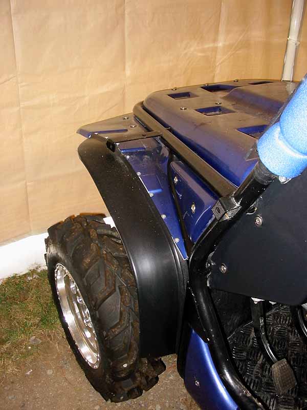

I thought I'd chime in here and say that I got some truck fender flare material from JC Whitney for about 35 bucks if I remember right. They have different contours for mounting; and I chose the flat surface one. (I think you can see it in the pic attached) I had to trim the fender lip off in order to get a nice "blendable yet square" fit. I used 1" screws with locking nuts every 4 inches or so. Then rounded the front of the flare with a box knife to blend into the fender. I think the material was the "standard duty" model.

Do they keep the mud off I could only find 4 1/2" flares and if I remember right the tires stick out almost six?
Oh absolutely! I was getting sand blasted before; now nothing comes off the front tires into the seats. Now if I can only solve the dust draft problem
If you have a windshield what I did was cut a few inches off the top and bottom it did not stop it but it helped a lot. Another thing i have herd of is to put a back on the cab. rocmoc said it will also help to remove the bottom of the dash. Cutting the windshield and removing the bottom of the dash will allow the air to flow through the cab and not create the vacuum caused by the windshield. And did you do anything about the rear wheels?
Tire tread pattern makes a big difference also. With the new tires, I am not getting nearly as much coming back at us MOST of the time. Unfortunately, the new tires/rims are even wider and have a greater potential. I will have to make something from fiberglass as the rear fenders had to be cut for the upward movement of the rear tires. This will require a entirely new fender design.
