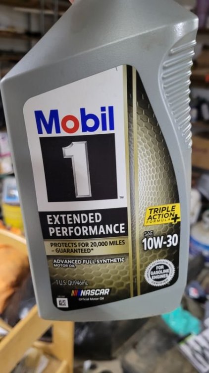

- I'm attaching a photo of the oil I used. Same the previous owner said he used. 1.4 quarts filled it up. Dip stick says its the right amount. But even after oil change... the oil on the dip stick is black and nasty. Could there be something broke inside the motor?

FUG GET about it. The eengine is shot. Sounds are hard to decipher but it sounds like a rod rattling around in there. All the time I kept telling you to check the oil, I ASS umed you understood not to overfill. When you overfill a small engine like that the internal parts act like an eggbeater. It hit me when you mentioned how black and dirty the oil looked. I've seen one run until the oil turned to a tar or pitch like substance and freeze up. Even tho you may have loosened it the engine is shot. CANNOT BE REPAIRED. Save your pennies and get a new engine.When you give up trying t hings you'll wish you had just replaced the engine in the first place.
PS| For a quick check, remove thge spark plug from engine. Find a long skinny screwdriver or you can use a pencil if you take it easy. As you pull the crank slowly does the screwdriver go in and out `with the` piston. If it doesnt move the connecting rod is broken and not attached to the piston. (No that can't be fixed at this point.
