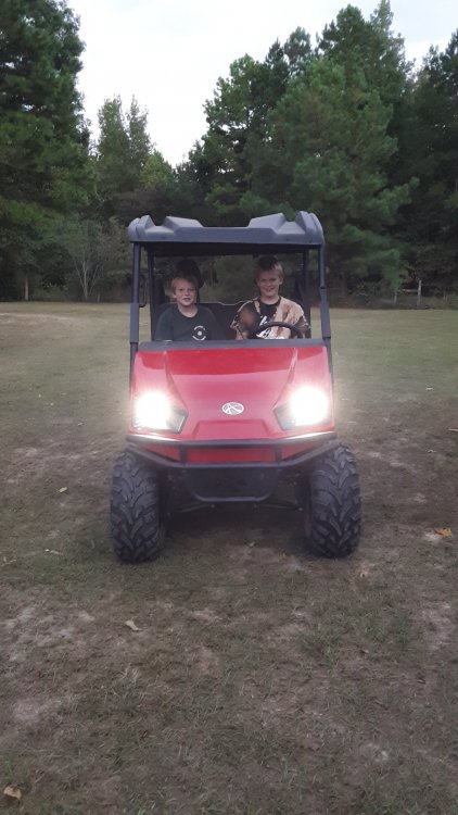

      I just picked this UTV up off of Marketplace. It needs batteries.
      I am installing a single 48v lithium battery.
      The on board charger, a NOCO Genius GX 4820, has a lithium mode.
      Has anyone here used this charger on new lithium batteries? I want to be certain of the compatibility before hooking the charger to this expensive battery. **
      I got in touch with NOCO and they told me the charger is fine to use on a new LiFePo battery.
      Nice charger. Many modes. New ones are running about $550.
