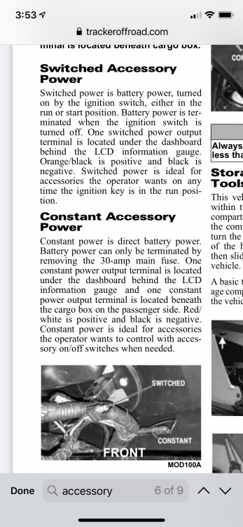

Are you using the switched or constant plug.  If you are using the switched plug (orange/black) you will not have power unless key is in the on position.

I've tried ALL Accesory plugs under the dash & Yes I understand that the key has to be On for it to work but with the key On I still can't get Power to the switches.
I contacted my local BP & there tech informed me I had to take the dash Off & dig for the Red & Blk wires.
Just Odd that there are 3 plugs under the dash & None of them have Power!  What's the Point!?
Yes. There are no fuses or relay for the Accesories so I put a fuse in & pulled another relay & put it in the accesory block. Still Nothing.
Also, on the wiring diagram it shows all of those plugs should have power.
The Only plug that has keyed power is under the bed. Which I originally thought was for backup lights like on the Polaris Rangers. NOPE! Just power when the keys on.
